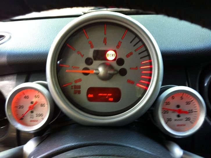

Oil & Boost gauges installed. Fabricated my own aluminum mounting bracket and ABS gauge pucks.

Good work fixing the gauge. Despite being cheap, the gauges look great. It's impressive that you fabricated the mounting bits. Did you create a writeup for that?

Thanks for compliment!
I saw a picture on the Alta site(?) a couple of years ago and really liked how the set up looked... but a bit $$. 2months ago, (after revisiting the notion), I finally got around to figuring out how and what materials I wanted to fab and mount it out of . The mount cost me under $4 in materials.
I didn't do a DIY write up...BUT I did take pictures of how and what I used.
I"ll upload the images and post them up in this thread, with a brief write-up.

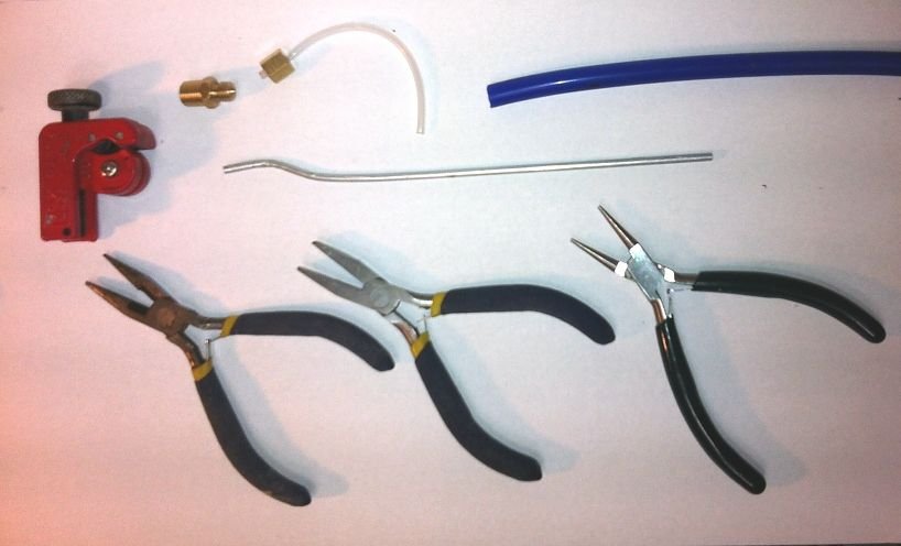

My unprecedented DIY gauge mounting bracket
Years ago I really wanted to upgrade to the dual Chrono Pack but it seemed a bit expensive and probably too intensive for my novice, techie skill level.
What I really wanted were easy to read "old school" gauges right in front of me. I later came across an image of an Alta gauge pod kit flanking the tach / mounted to the steering column. I was sold!....Except for the price.
Seemed like a simple enough concept so I decided to fab my own.
I didn't really have plans to do a DIY write-up on how I and why I decided to create my own gauge mount. So I didn't take many pics.
Here's what I have...FWIW....
Once I picked out my gauges; I kept my eye out for any kind of cylinder that might be the right size to hold/sleeve over the body of the gauges.
A few weeks later I came across a couple of cans of industrial grade expanding foam sealant (aka "great stuff") at a construction site dumpster.
The caps were a perfect fit! = 2-1/8" ID x 2" deep.
The Polypropylene caps were pretty sturdy.
After cutting off the tabs, scuffed them w/220, painted with black plastic paint and Dremeled a 5/16" hole in the bottom/"back" to run the inlet tubing and bulb wires.
At my leisure; I picked up a 1/2"w x 4' length of aluminum flat stock at a local hardware store (Home Depot) = $4+change.
*Note: Use a 1" aluminum flat stock instead...Details below....
I went out to the Mini with the flat stock; eyeballed, measured and made some mild registration bends. After taking some mental notes I cut the aluminum to length.
Made some conforming bends (from my mental notes) with a couple of pair of pliers and vice grips.
* Note: I cushioned the teeth of the pliers with a small piece of folded fabric to avoid leaving tool marks. Both ends of the aluminum stock were then shaped circular (to hold the cap/gauge cups), by wrapping them around a spray paint can. Then formed a bit smaller until it conformed to the size of the caps/gauge cups. At the excess ends, I bent a 90° "clamping tab" and drilled a 3/32" hole for a #6 x 1/4" L machine screw and nut to clamp the cup in place.
**Note: the eccentric tabs in the center span of the bracket (held in with black screws), was an after thought, when I realized the 1/2" stock was not wide enough to drill the holes that would line up with the Tach mount bolt holes.
* 1" flat stock would have been wide enough to work perfectly!
Pictured above is the kitchen counter set up.
I didn't take photos of the installation process. There should be a few instructionals and youtube videos to guide one through routing the hoses and connections from the engine bay up through the steering column.
But I will say, that you will need longer bolts/screws to replace the factory ones that bolt the Tach to the steering column. About a 1/4" - 3/8" longer - If I recall correctly.
Somethings to seriously consider....
On a side note, Regarding the tubing routing/installation: #1- I refuse to use nylon tubing.
Especially for the Oil Pressure gauge and connections. I always use 1/8" copper. #2- I preferred not to use the cheap nylon vacuum tubing that came with the Boost gauge kit (see the nylon kinked connected to the brass fitting in the image? = GARBAGE!).
I opted for 1/8" ID silicone tubing: (pictured in the upper right corner in the image above) - 6' Length snaked from the intake manifold all the way up through the dash at the steering column. At the Boost gauge inlet; I improvised the connection with a 1/8" diam aluminum tubing (I was out of copper). The Boost gauge was mounted to the right of (facing) the Tach. Clearance to the right of the Tach and the dash is a limited/tight tolerance between the back of the gauge pod and the dash. I had to make a slight "S" bend in the aluminum tube to jog around the corner of the dash edge to align with the inlet connection at the bottom of the Boost gauge. *In order to finesse a nice smooth "S" bend in the 1/8" aluminum (or copper) tubing; I fed a small braided stainless steel cable through the tube which prevented the tube from crimping, crushing or deforming while using pliers to form the curves. The remaining end of the aluminum tube was then cut to length and slid in super snugly into (approx 2") the silicone tubing protruding out from the grommet behind the steering column. Insuring it will never have a kink at this junction. The provided brass securing nut and compression sleeve slid on perfectly over the aluminum tube and proved to be a tight leak free connection to the gauge .
Done......?

The Real Cost of Going Cheap..
As previously outlined in this thread; Although having some inaccurate reading issues with the inexpensive Actron Boost gauge, I felt confident in my routing and connection of the vacuum lines were perfect.
While reading a thread here on NAM - Where does his go under the IC??? , Thanks to @BlwnAway post, I remembered noticing the small hose of my fuel re-circulation EVAP line was kinked during the installation...
but forgot to address/replace the hose with a new one at the same time.
I Removed the intercooler this morning, to make the the re-circulation EVAP hose repair/replace. What I immediately discovered was the **Dorman "T" connection I used for the Boost vacuum line had snapped!
It now makes sense why my vacuum/-in.hg read so high at idle and boost was on the low +end. (sorry no repair pics).
Above are the broken/failed connections.
I replaced the "T" connection for the Boost along with replacing the re-circulation vacuum EVAP hose and rubber coupler with a new one.
I also decided to replace the 1/8" aluminum tube with brass which I connected to the gauge inlet.
Everything tight and leak free -The Boost gauge now reads the correct values = -20in.hg cold, -16in.hg warm idle. +13/+16 Boost @5,800 RPMs.
**Avoid the Dorman Vacuum Connectors at all cost! TRUST ME.
**My initial impression regarding the Dorman multi pak vacuum connectors is that they seemed awfully brittle. Like they were made via old (resin & powder) 3D printer material that was once used and could potentially break/fail.
My instincts were right.
Edit: I O'Reily Auto parts has the 1/8" black plastic (polypropylene?) 'T" vacuum connectors. On my way there now. I will fix it right tomorrow.
Boost on!
