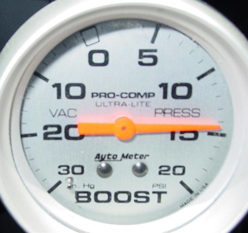

WOT is as already suggested, more or less 15 psi. I attached a cr@ppy picture of my boost gauge reading at WOT with a 15% pulley for reference at more or less 14.5 psi.
