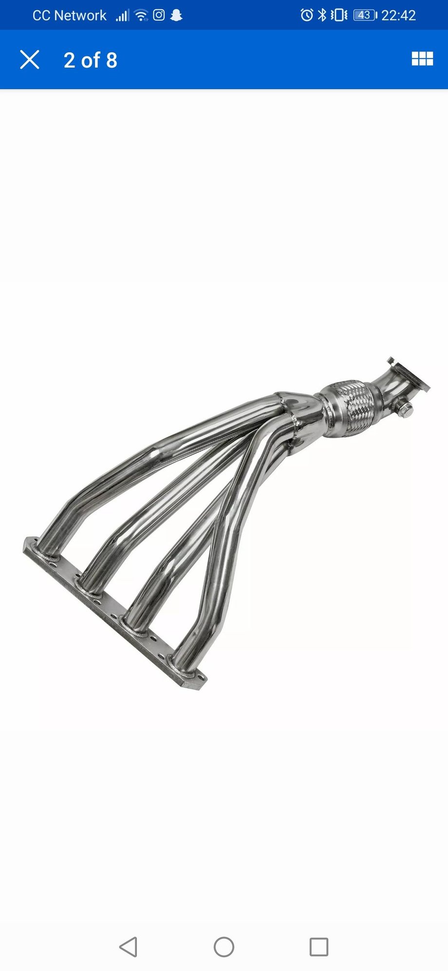

edit:: something I want add is this was done for $0 and even if you wanted to do the same starting from ebay headers (because they will be much easier to work with than stock but not as good as custom) you can find these headers from good sellers with decent welds for$90-$120.
We needed some extra pipe (all 1.5 inch) for this but we more or less did it with one elbow and some scraps as well as the piping that was already in place.

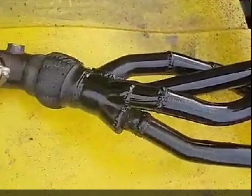

What we ended up doing was making runners 1 and 3 short and runners 2 and 4 long.
Runner 3 was left untouched to keep the manifold in the right position and because it was already a shorter runner than the others at 13ish inches.
We then cut out runner 2 and put it in place of runner 1. Then we made runners 2 and 4 roughly 30% longer making them roughly 17 inches long.
This turned out to not be too hard and I am pretty happy with the results. Also I can say I noticed no appreciable power loss and they been put through the rev range and taken to 100 mph at this point. Overall I'd say if you enjoy the sound of the rumble 9 out of 10 would recommend.
Here are some pictures of the process as well.
The collector
overall shot
headers we started with

Anyone who is curious the headers have gone through a little bit of work since I last posted here about them. I have gotten a new flex pipe, which is actually a flex bellow for a Duramax, and is much stronger than the flex section that came with the eBay headers. I talked to a few people about them and they said that the collector that we had to modify for the headers could have contributed to the failing flex joint. Also I can think of a couple more things that may have caused it to fail as well so I decided to upgrade the flex joint a good bit and see how it works. I will be welding in the new flex joint soon and we'll make another video and update the thread when I have results hopefully they come out okay and will sound good like I hope.

Hey all it's been quite some time since I updated on the UEL headers but they are finished now. I replaced the original flex section with a flex bellow which has proved much stronger. I like the way they sound and even though I run them catless with a one all mod and an vibrant resonator they are not that droney and they are quite poppy. The video attached isn't great by any means but it shows a couple of clips of the exhaust at different speeds I'll try to get better clips soon.
