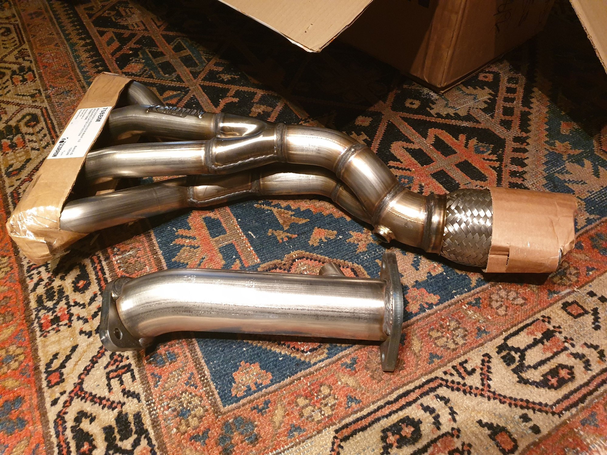

I ordered a scorpion exhaust manifold, it has an additionnal plug for a AFR sensor which is nice!

Old Feb 21, 2019 | 11:52 AM
SuN13300's Avatar
SuN13300
Joined: Sep 2014
Posts: 33
Header is here!
I think Scorpion was in only 4-2-1 available, all others are 4-1 I think
