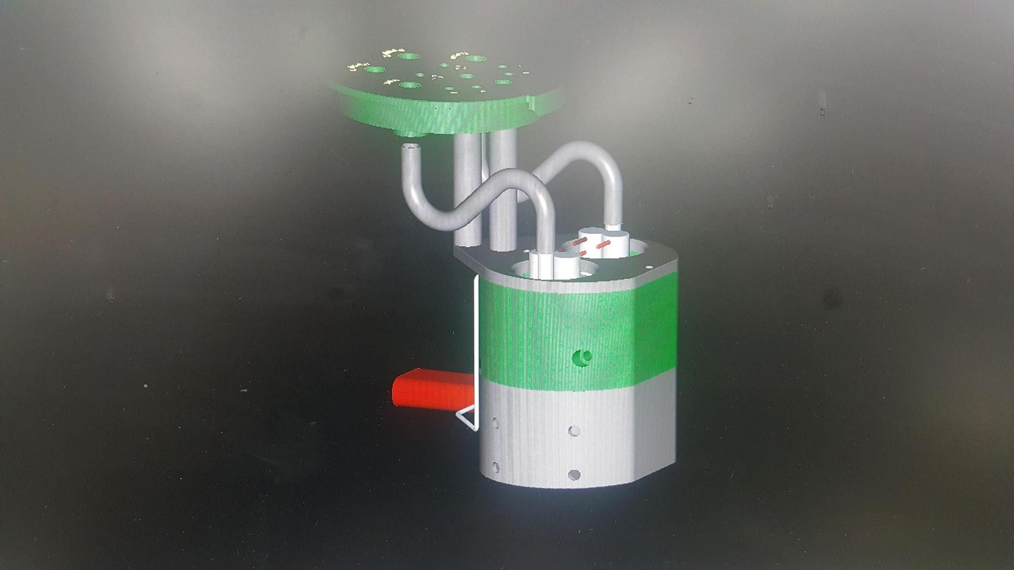

I have to get final pricing for all the different kits as there are so many options. This one is waiting on my new fittings for the dual walbro pumps that I just custom made
RMW dual pump fuel system capable of 1200whp
