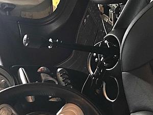

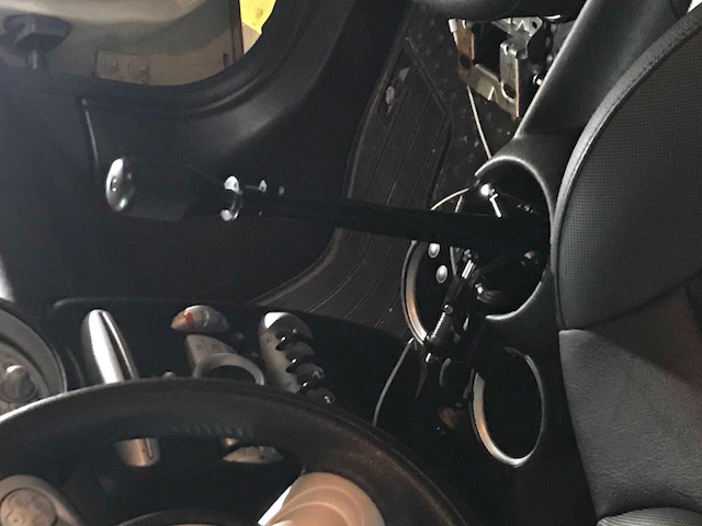

My Coolerworks is installed and boy do I love it, driving home from my tuner yesterday I could not shift to 6 gear is there any kind of adjustment I need to do?
Ben

You do have to make alignment of the shifter. For me they are intuitive. There are up to 4. If you are sure go find the install instruction for the CAE on the German home site.

One thing to note. The shifter has a centering spring, and so too the gearbox. You want them to be at rest at the same spot. The other adjustments are for setting the end stops for the shifter's left/right limits; and the reverse lockout.

It was the travel set screw adjusted it and all is great, thanks for the hint to look at CAE adjustment.
Ben
Love the shifter.

Instead of Curt Triflex 51140 I bought a Tekonsha 90195 P3 brake controller instead. It is more polished while costing just a little more. As the space between the dash and the knees is already less than generous I did not want to install there like most people would. I want a location that is most ergonomic, and hopefully with minimum negatives. I came up with the idea to repurpose the location for the ashtray.
I will never use the ashtray nor the 12V receptacle in it so this is a no brainer choice
While repurposing the ashtray location seems good, I need to check interference with the use of the two cup holders below. Also I want to maximize the utility of the ashtray opening. I set out to make provision for future installation of mobile device power supply.
the way the ashtray is fastened to the center console make this location ideal as I can reuse the two fasteners
more filing and refining as the dash opening has many bevel edges
I wanted to maximize the utility of this real estate so I tried to leave space for future installation of a mobile device power supply. For mounting the brake controller, I want to leave the option to use both type of mounts - a fixed mount (top) and a removable mount (bottom) so I drill two bolt holes that can accommodate either.
checked clearance against the worst case cupholder interference
The brake controller has 4 electrical connections. B+, ground, brake light, and trailer electric brake power output. The B+ and trailer electric brake power output wiring requires large diameter wire to minimize voltage drop so I chose 12 AWG wires. That should be more than adequate for the 18.5 feet James Cook and tandem trailer of 5000 lb capacity. I managed to find the contact insert for the trailer connector.
only the B+ (black) and Brake (blue) wires in the diagram carry the trailer brake current so I use 12 AWG for both; the ground (white) carries only the current for the controller electronics (no more than a few 100mA)
I made the tap connection with soldering so it is 100% secure; I also adequately strain-relief the wire
I tap into the cigarette lighter harness for the ground reference as it is the easiest; with this the wiring for the controller's harness is completed and I can mount the controller
I designed the aluminum faceplate so that the harness may be detached should in the future I want to modify the faceplate to add another accessory
I deliberately offset the brake controller as much to the left as possible to avail some real estate for adding another accessory in the future
this is the ideal location for the brake controller as I can use the right hand to modulate the manual brake control lever should it be necessary
I next dressed up the B+ power supply wiring into the driver seat box where a 30A auto-resettable breaker will be installed. I want a location where I can access it without having to remove the driver seat, so I came up with a way to mount it in the fuse panel behind the plastic access door. As one side of the breaker is the starting battery B+ the installation must be extremely secure and leave no chance to accidental short circuit.
the self-resetting breaker
I happen to have a piece of angle aluminum of the exact length for use as a supporting rail
I used locknuts so there is no chance the breaker would come loose and fall off; shorting the upstream side of the stud will be catastrophic
there are these two existing hole on the seat frame that I can utilize to fasten the aluminum support rail
I secure the aluminum rail to the seat frame utilizing the two existing screw holes - with Loctite
this is the battery B+ connection that one cannot afford to short out as vehicle fire is what is made of
a professional installation accomplished
In this entire trailer brake controller installation, I didn't cut or drill any hole. Everything I did is completely reversible to original, including the ashtray assembly.
with the help of my neighbor, we put the seat back - I hauled it out all by myself and it is very heavy and awkward
