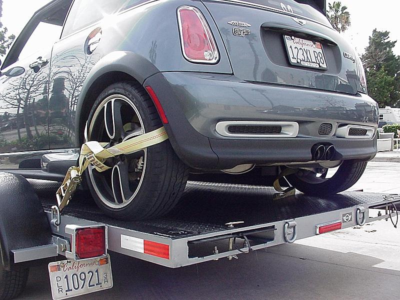

Nice trailer.....but boy those wheel strap attachment locations are way to far from the wheels.
Old Jan 17, 2008 | 07:59 AM
danssk's Avatar
danssk
Joined: Jan 2003
Posts: 14
From: Huntington Beach, CA
The tie-down locations were not a mistake in measuring......If you tie both straight up and down the car can still try to move fore and aft.
This way, you pull onto the trailer 'til you hit the stops on the deck, set your handbrake, install the rear straps first pulling forward, then secure the front ones pulling aft.
Now the car cannot move in either direction
Old Jan 17, 2008 | 08:05 AM
ScottinBend's Avatar
ScottinBend
Joined: Jun 2003
Posts: 3,589
From: Oregon, USA
But the straps are located above the center line of the wheels. They should be at or below the center caps. Check with anybody that does vehicle hauling.
Old Jan 17, 2008 | 09:11 AM
danssk's Avatar
danssk
Joined: Jan 2003
Posts: 14
The actual pulling is done at about the centerline of the wheels where the strap meets the metal ring.
Believe me, I've done lots of towing (street cars, race cars, trucks) and having all four straps pulling against one another is the best way to keep the load stationary.
Pulling outward also prevents any possible contact with the coachwork by the ratchets.
The slings grabbing the tires are also a good way to keep from bending anything under the car when you secure it to A arms, suspension parts, etc.
I took this trailer up to well in excess of the speed limit here in California and swerved it around.......the car didn't budge.
See attached photo
Dan

Yea.....that pic shows it a lot better.
