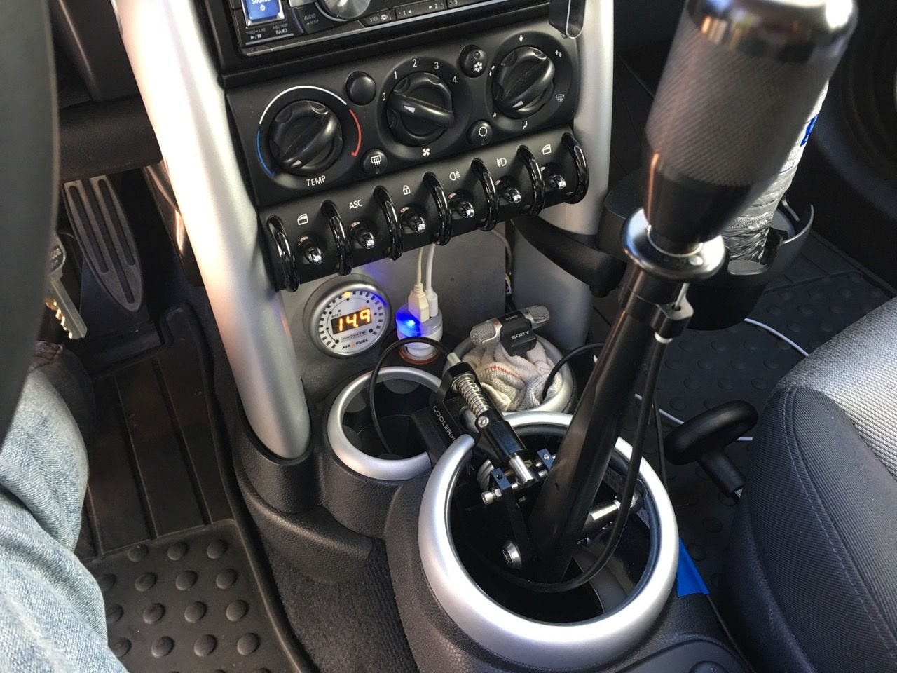

gopro external microphone
It is such a luxury to have our track team A/V engineer with us this recent event. He set up this Sony stereo condenser microphone and the audio is better than before. It fits in nicely with Mini's all business interior esthetics . Attention to details. The microphone is hinged flat so it just barely clear the Mini-Fini cupholder when it swings inboards and just right on top of the stereo mic. He said there may be a bit more fine tuning he need to do to reduce the wind buffeting because of driving with open windows at high speed. We would try a custom made wind muffs next. He also pointed out the disconcerting banging from the brake pedal release stop and we will be looking into that.
Oh, and the WB O2 sensor is holding up very well so far with the punishments from all these track events.
Do I assume correctly that the video in the previous post included this external mic? How does it hook to the GoPro? The sound in that video is quite good through my headphones.
Yes. External mic is used as the GoPro is mounted to passenger head rest post so it is in the direct assault of the wind. The Hero 5 Black requires an active adapter that must be powered for the mic to work. The adapter has a built in stereo ADCs. The details are in this old post.
not shown is the USB-C cable providing power to the adapter

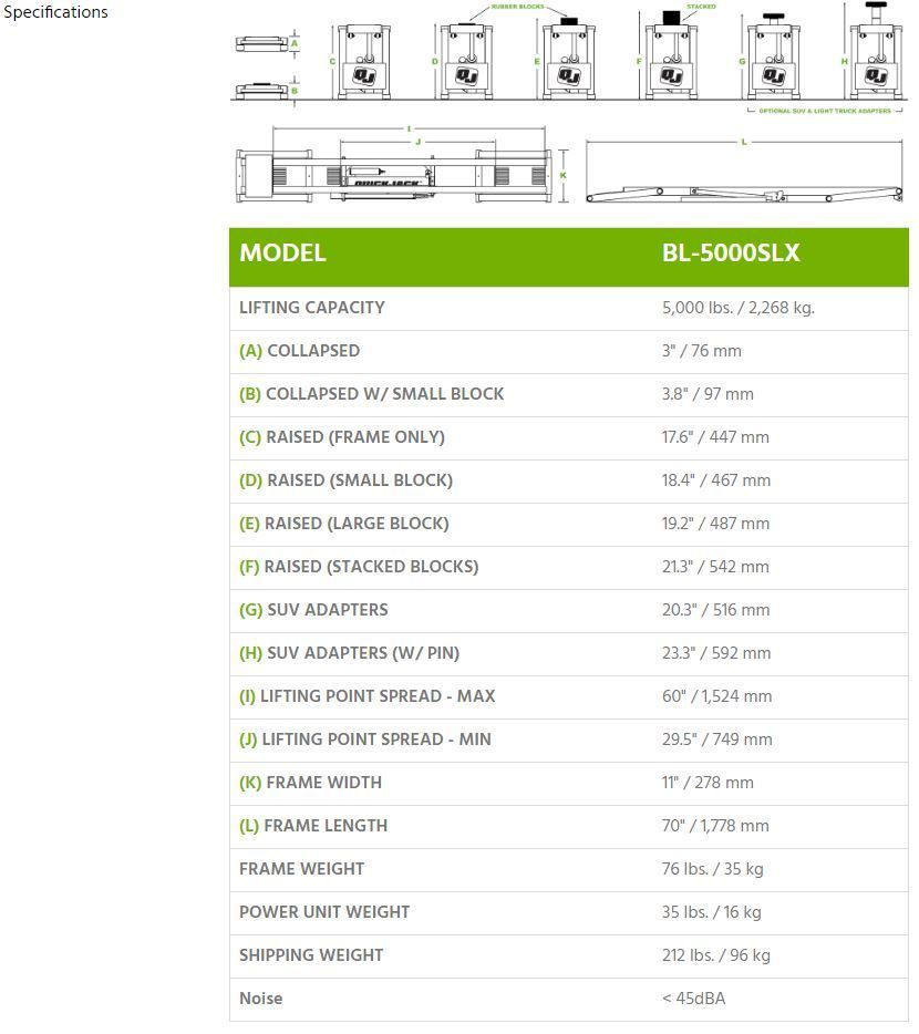

I bit of quick checking of the lift point locations of the Mini and GT4 the BL-3500SLX is out of the question. It should work for the Mini but GT4 jack point spread is 52 inches, which is beyond the 3500 50.5" max spread. The other dimension that one needs to be careful is the swing action of the parallelogram which is a function of the designed lift height vs the contact patch of the tire and the corresponding jack point.
I checked the BL-5000SLX and it should fit both cars. I have seen folks use the Quickjack at the track, but I don't think I will ever want to carry this much to a track. This means 120Vac pump would be my choice instead of 12Vdc.
Jacking up the GT4 without a lift is a major PITA, much more so than with the Mini. I have yet to attempt so this makes the decision easy. I have no disillusion that it does involve a bit of time to set it up each time because of the hydraulic hoses and pump. Each jack unit is 76 lb and they takes some space to store.
