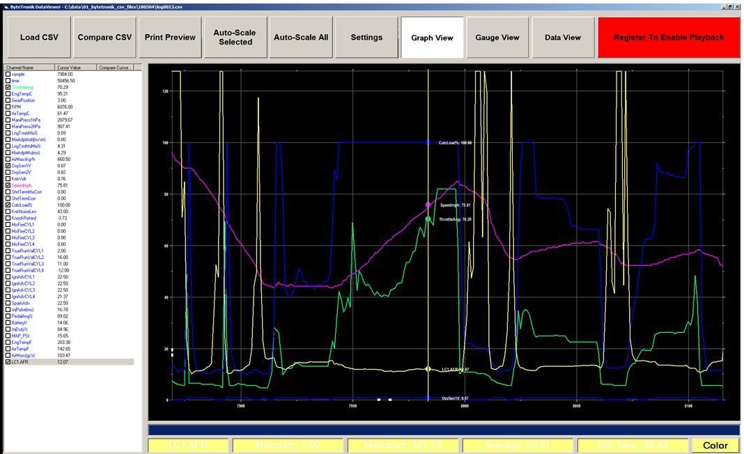

OK. I broke down and bought the Dataviewer from Bytetronik. I am still unable to register the software after the installation onto my Win 7 desktop, which I was told only affect the ability to play back.
Ignoring the registering problem I played with the program with a captured CSV file from the track day. Here is a screen shot in the middle is somewhere accelerating out from a turn and onto the straight. The pink curve is speed which peaked out at 107.5 MPH. The green curve is throttle plate position that max out at about 82 degrees (no Sprintbooster of sort in my Mini so it does not quite get to 90.0001 degrees ). The blue curve is calculated load which has many Plateaus - what do you expect when you pedal to the metal? The yellow curve is the Innovate MTX-L WB lambda sensor. And the other blue curve hugging the x-axis down in the mud is the upstream narrow band O2 sensor. Quite interesting.
To make sense of just the WB A/F mixture you have to ignore the overtly lean part of the yellow curve as when you slam shut the throttle right after wide throttle angle even the WB sensor throws up its hands.
This is just a very cursory shallow dive into the recorded data by the Bytetronik Miniport.
