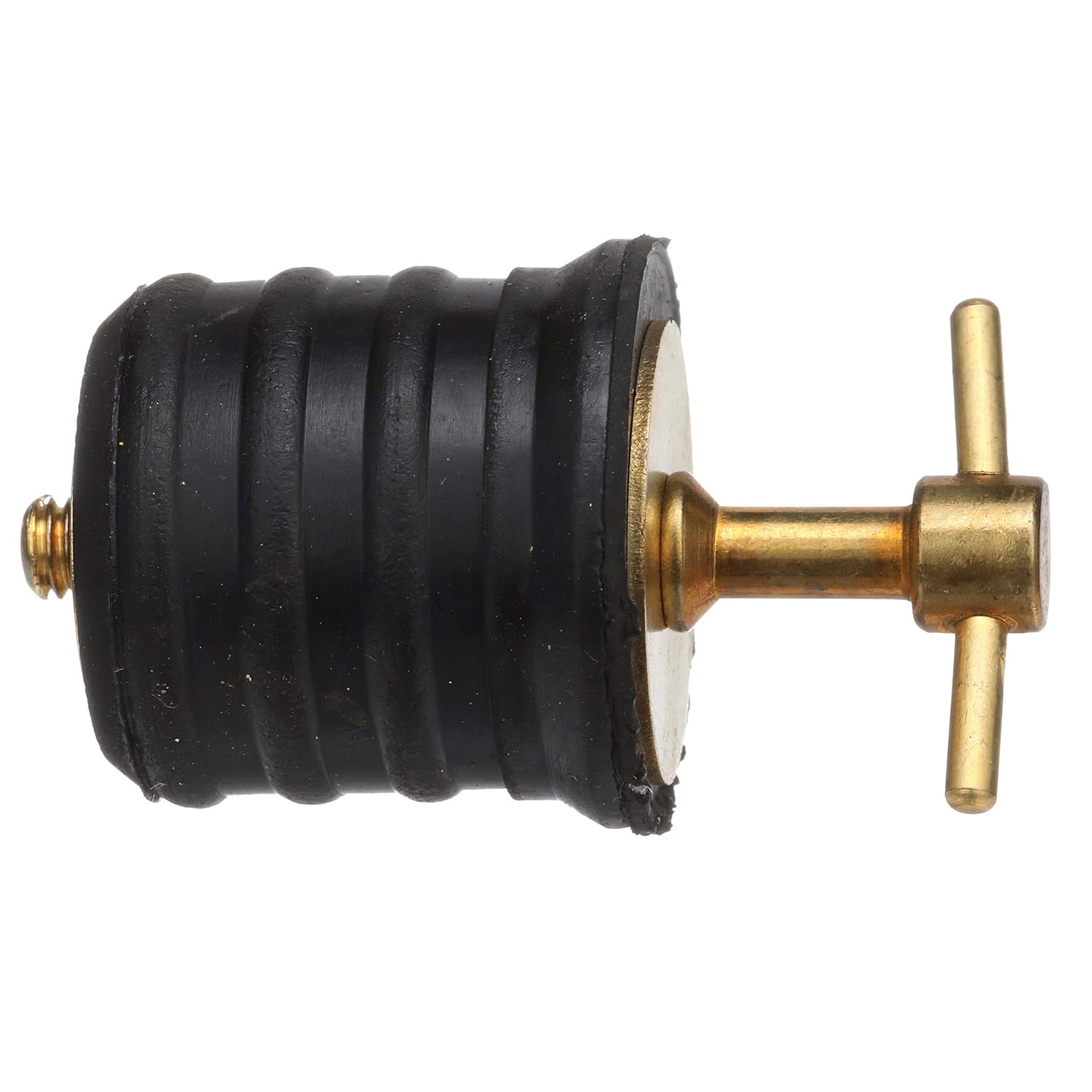

It seems like you could leave a piece of the hose going to the noise maker, insert on of these and then put a hose clamp on the tubing as well which would be solid.
https://www.amazon.com/SEACHOICE-Twist-Turn-1-25-Inch-Marine-Neoprene/dp/B002IZHF08/ref=sr_1_47?keywords=1+1%2F4+rubber+plug&qid=1570153772&sr=8-47 https://www.amazon.com/SEACHOICE-Twist-Turn-1-25-Inch-Marine-Neoprene/dp/B002IZHF08/ref=sr_1_47?keywords=1+1%2F4+rubber+plug&qid=1570153772&sr=8-47
