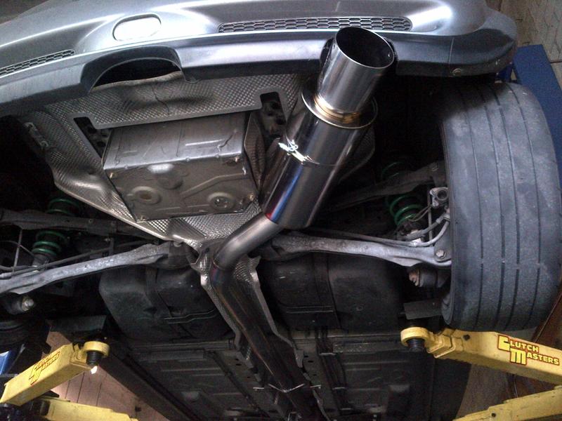

Hey guys, i have a problem, i enjoy exhaust too much and how they look. i love my magnaflow sounds great looks great, but im kinda bored with it now, and im wishing to do somehting a bit more radical.
somone on here did a 3 inch exhaust to a single dump with a HKS Can. im digging the look alot, not sure how i feel about the 3inch and the HKS. i was thinking of the same look ish, pop out on the non s side, getting the non s valence. running a magnaflow (cause i like the sound) or a borla round muffler. and running a resonator in the normal location after the header to help reduce drone
https://www.northamericanmotoring.co...t-install.html is the reference
i was looking initially at 10426 magnaflow muffler
also have no idea what i want from a resonator, i know vibrants are really good, but i know they reduce alot of sound (i will have a racing header so this may be good)
looking for you guys's thoughts and there will obviously be a before and after with the magnaflow non racing header, w/ racing header, and new "cat"back exhaust
i could also look into other mufflers, but i know those are easy to get, flow masters are another abundant brand, akaprovic would be nice as well but i cannot find one
**edit picture added is what im thinking of**

Depends....you want function, or just looks?
Go to big with a small displacement motor, and you loose tourqe.....
Another thought....
To go with a r50 style straight exaust, you would need to move the battery box...or have a huge custom bend...
And then sound....single sided or non-resonated exaust tend to drone...lots...OK for short trips, but pretty annoying after a few minutes....
Its your car...you can go for the big diesel look exaust coming out your butt...but IMO it looks kinda...er..out of place..in a cartoonish kinda way...even beyond "rice" boy racer...just overdone.
The thinking and brainstorming is good though....
Many options....
I prefer TONE and no drone....a 2 or 4 HP gain would be nice bonus....weight loss would be good I guess....
Another thought....have you changed your tips out? Can make a huge difference in looks!!

i love everything about my magnaflow. just was thinking of something different and out of the box. my goal is to not have a fart can sticking out of my car, but just to offer up something different. i really like what the reference thread shows, great looks i just wouldnt use a 3 inch exhaust cause thats way to large for our cars, id either stick to 2.5 or 2.25. i have a bit of drone now with the magnaflow catback, nothing that isnt cured by a bit of music, one of the reasons why i was looking for some opionons on good mufflers and resonators, and the r50 uses the same hangers on the side, just exits out one side, im trying to stay away from the straight thru cause i dont want to move the battery box
you will want some noise gone.
I had 3 vibrants all in line and it was still head-ache inducing in 5 minutes if you ever took it above 40% throttle
Would not be bad for a track day with the windows down and a helmet on, but that would be the only way.
if you want radical I would suggest a vibrant up front and a small straight through muffler at the back.
magnaflows will take a lot of sound out, but it is quieter than what I would deem "radical"
if you really want a radical sound you need thin wall (.028-.035 which lands you in titanium territory at ~$40/ft price just for the tubing)
gets that race like reverb though.
(invidia does not count)
we can talk turkey if you want something custom.

i knew you would chime in soccer and i was hoping so!
im not gunna go as radical as titanium tubing normal stainless tubing, not sure wall thickness. the goal is not to be wake the dead loud, thats for my dirtbike, which at full throttle is 102 db
but im looking for something spirited, my magnaflow catback is actually not loud enough for my tastes catless will prolly be where i would want it.
but i still want the sytle posted above. its good to know that the vibrants dont dampen that much, so if i go with the ultra quiet and a mangaflow muffler i should be all set?
the rear trim will be done correctly, the r50 valence and side trim pieces are a must, no need to have two holes in my valence. i cant really do trackdays so straight pipeish would be annoying esspecially since i go on multiple road adventures a year, (minis on top, minis in foliage, next year dragon?)

and you think this is too loud? or perfect street tone?
ill have a 4-2-1 header in at somepoint soon, right now its catless and if i cant get the CEL to go away i have a high flow cat to go in, i just dont wanna hack it up immediatly.
my tolerance of sound im sure is higher than most, i have a loud dirtbike, mildy loud sportbike, and my car is much quieter than both, ive heard some great sounding r56's and they definently have less pipe and thats the volume i want to be at granted they have a turbo, and that muffles a decent amount
i did hear your video(one i thought was very quiet), but volume is hard to tell in videos, im not looking for straight pipe or glass packs, i would potentially do glasspacks with stock header and cat
