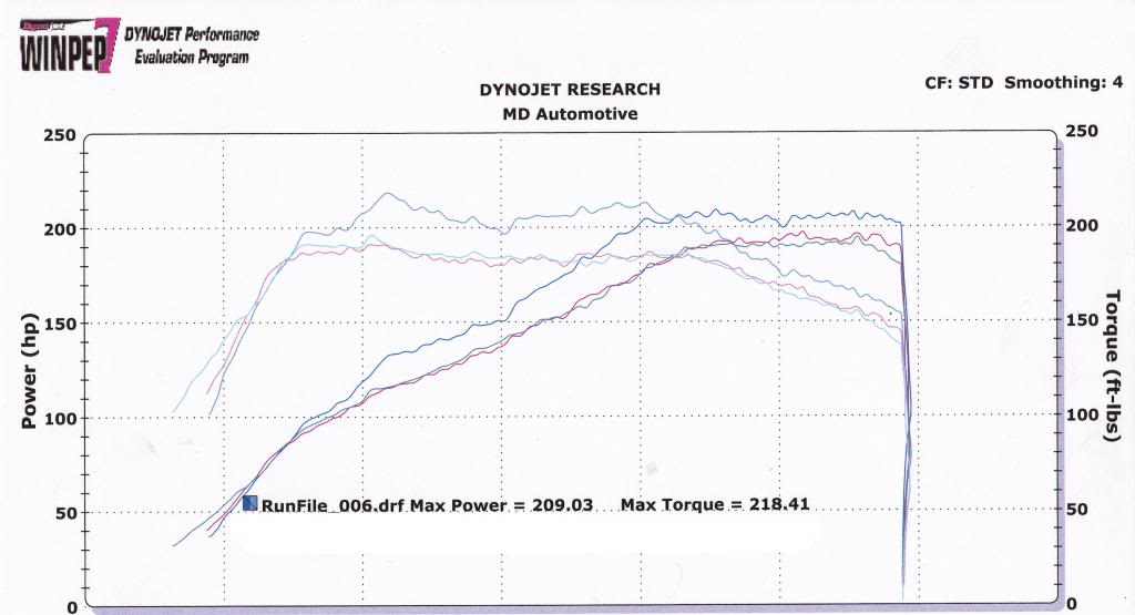

Here is the final tune (DNA remap, Wagner FMIC, DNA Filters intake, decat and cat back) v stock map (car had a decat and cat back system only):

Originally Posted by ra2fanatic
Are you sure that is correct? To me looks like the higher early curves that drop off are torque and the the steady rising curves are both hp cruves. The math doesn't add up otherwise.
Old Feb 26, 2014 | 09:51 AM
I'll scan BOTH my graphs this time so you can compare. You were right on the curves.
I will say this now though after looking at the graphs. AP after 4.5k has nothing left in it while the power in the DNA tune keeps going.

Battle/DNA
AP
Battle/DNA
AP
Nice, that's a lot easier to read, thanks! DNA definitely has much smoother overall power and that HP curve towards redline is just sexy

I don't know if these are comparable (same day, etc.), but it looks like:
- The shape of the DNA tune is definitely nice, but
- It looks like the AP provides a pretty substantial amount more power (especially when it's really a function of the area under the graph)
Is it fair to compare these?

Not sure you can really compare because the AP is on Stage 3 and my DNA map is Stage 2 with linear mapping.
Without me even making a comment on my tune, I let my friend drive it and he proclaimed it felt faster than his Stage 3 Cobb. Not my works, his. Two completely different tunes and the graph shows 9whp more, but the feels are completely different.

Battle/DNA
AP
Is the top one AP or DNA? I'm a bit confuse... and thats AP Stage 3?

It's hard to compare tunes when you can't see the boost or fuelling.

It's not hard to compare, the AP Stage 3 made 221 PEAK HP, with a fairly flat power curve, but did drop off to below 200hp by the time it hit redline. The Battle made 209 PEAK HP with a liner curve, and made peak HP at top RPM. So the Alta AP will hit harder in the mid-range, but the Battle will pull harder in high RPM. However keep in mind that he has LINEAR maps for his Battle Tune, so the power is lower in the mid and therefore more predictable. Battle can also tune to have a curve similar to the AP, if you want it to hit hard down low. Plus he may also be able to flash a Battle stage 3, to get even higher numbers...
Top is DNA, bottom is AP. I did write Battle/DNA and AP just above each graph.
And yes, that is AP Stage 3. Properly modded. I don't cut corners if you think I'm deceiving anyone.

Originally Posted by george_talbot
So your not interested in seeing the boost curves and fuelling?
I am, just to make sure they are within safe levels. I was just saying for the sake of comparing power and drivabilty between BT and AP they are not needed. Battle does tune conservatively so your not running lean or ridiculous amounts of boost, since they can't see what your AF ratio is. They told me they can make my tune better if I send them a dyno showing boost and AF ratio. With AP you are stuck with what you have, if it's too lean or you want a tweak to the curve, you're out of luck.. That is what made me choose BT over my old AP...
The main issue with comparing the graphs is they are not apples to apples. We are comparing a Stage 3 AP to a linear Stage 2 BT. What would be nice is if we had Stage 2 AP vs. Stage 2 BT, and a Stage 3 AP vs. Stage 3 BT. Although technically speaking we should be comparing a Stage 1 AP to a Stage 2 BT, because a Stage 2 AP requires a catless DP where a Stage 2 BT does not...
