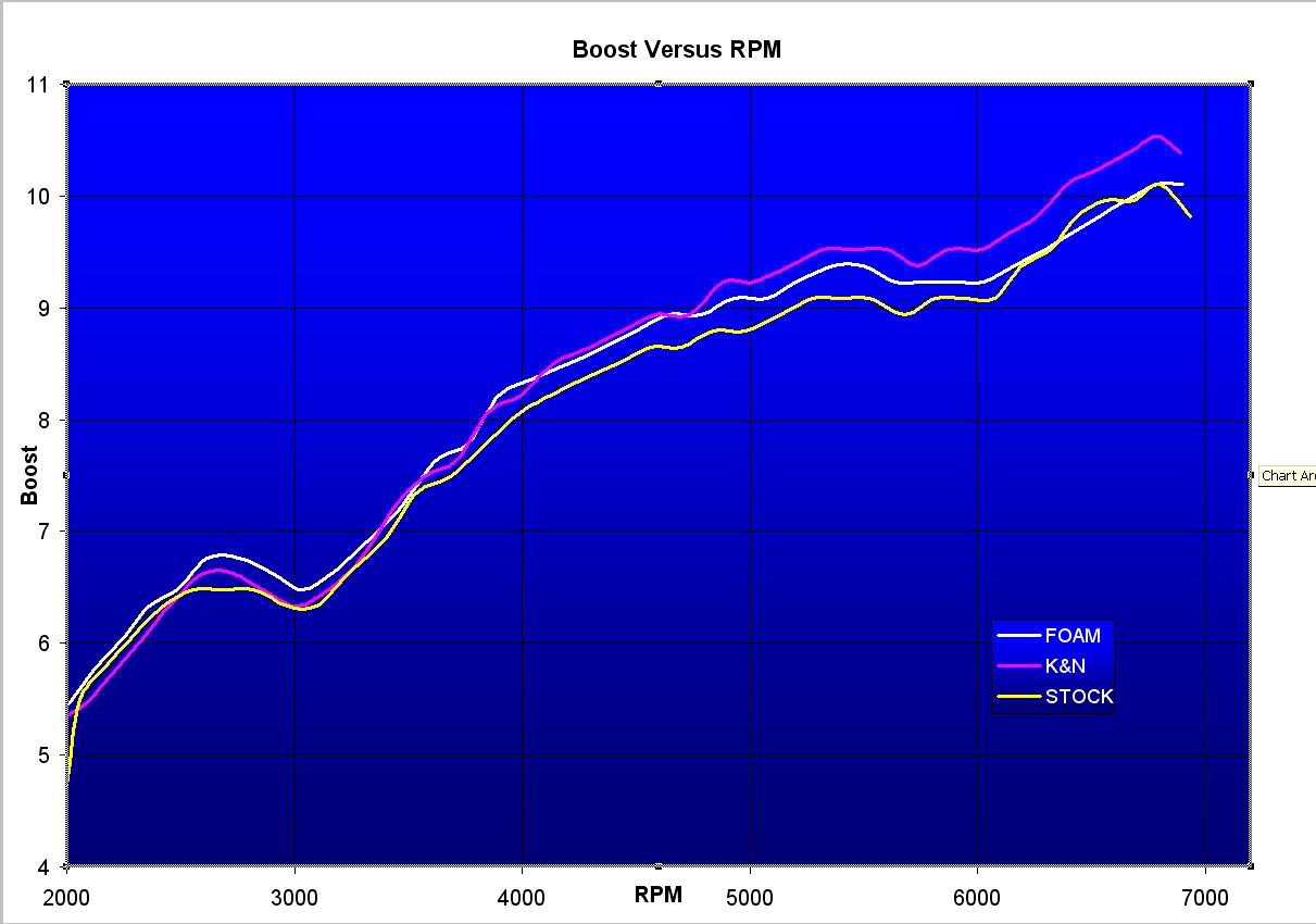

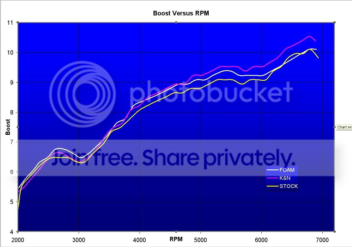

I have a few boxes of UNIs that I experimented with when I "designed" this intake. Some of the smaller ones fit but they're very small and didnt flow as well.
Cheese

Hey Cheese,
Do you have a similar plot adding in a typical CAI ??
BB
Cheese

Originally Posted by Blue Brummie
Hey Cheese,
BB
BB,
Andy has a similar plot on page 2 of this thread comparing the K&N to the Alta. His numbers are different becuase my analysis was done on a stock car.
Cheese
