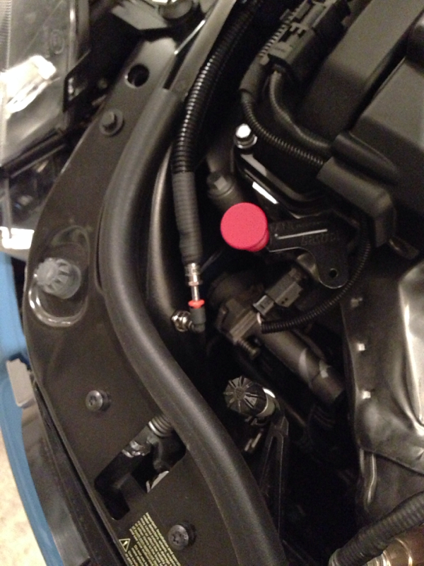

Can you post which kit, nozzle size and where on the pipe you are spraying?

Originally Posted by MarioKart
Can you post which kit, nozzle size and where on the pipe you are spraying? Thanks Mario Sent from my iPhone Office
It's the HFS4. I'm using 0.6 mm jet with 0.7 mm restrictor which gives me ~270 cc/min. It's installed in the cold pipe next to the dipstick. Currently it's about 80% methanol. I will transition to 100% as I refill the tank.
Thank you. I will check out their website
Exactly were I have mine.
You certainly wrapped up the meth line lol, mines all exposed haha.
If you ever go .8mm with no restrictor, you'll be close to 30 degrees under ambient.
