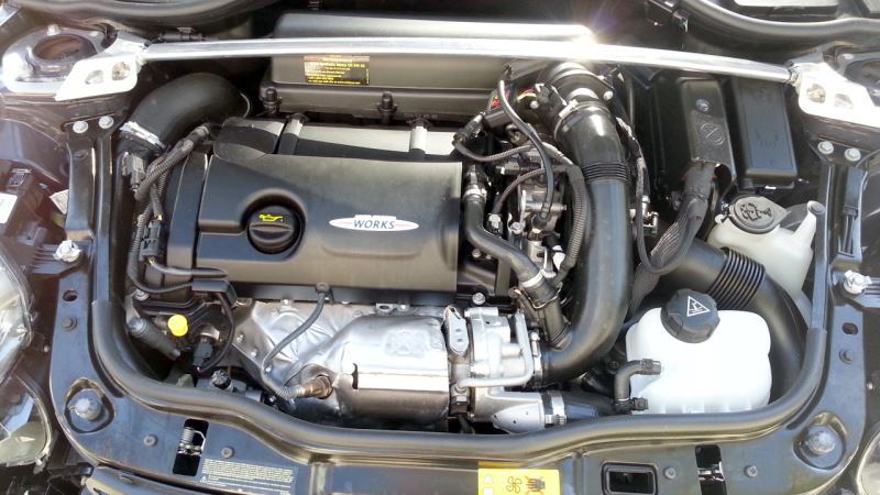

On the cold idle I'm not sure its anything we need to bother with. But, when time permits I'll look in to it.
Also did an install on a local GP today which has the JCW setup. During our impromptu testing it was putting out around 16psi stock and around 19psi with the JB+ at 33%. The owner is planning on using 30% E85 so we'll see how it goes.
Wow....if my math is right thats about 250hp. That GP2 guys must be happy.
