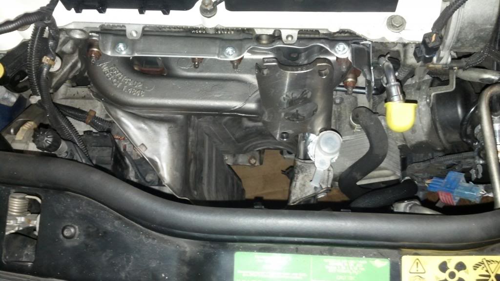

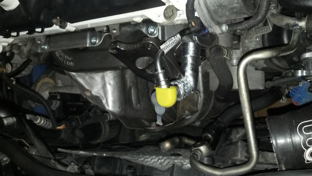

Almost pulled the trigger on one of those manifolds.....just can't warrant completely tearing down the front end just for that part unless it makes a huge difference...which I have no idea if it does or not.
At least in this case it works out for you since the turbo HAD to be removed.
Thanks for all the photos

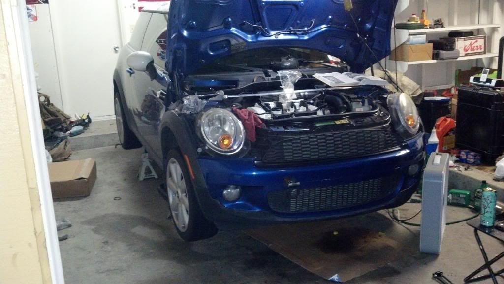

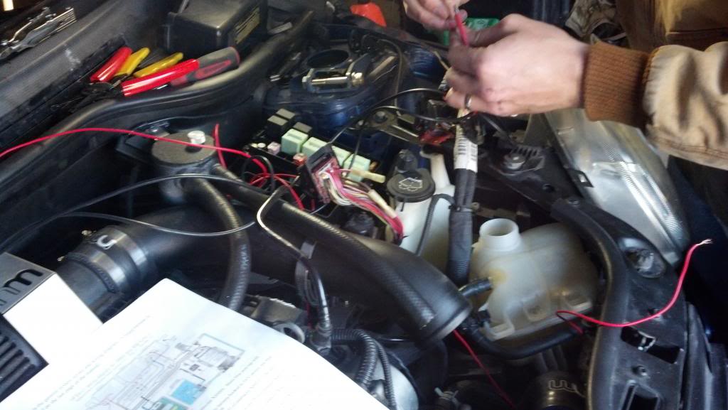

Well halfway done with the HFS4 install. The turbo will come in next Thursday for a Friday install and hopefully a Saturday tune. Wiring is a little crazy so I had my wiring guru friend come over and do it up for me. All in all it was a short day same with tomorrow.
