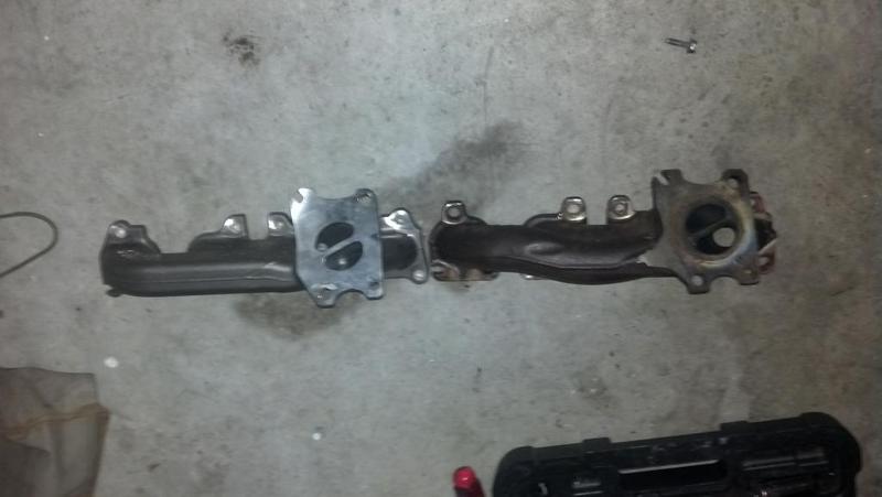

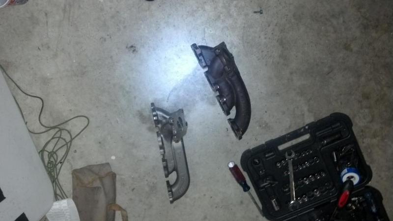

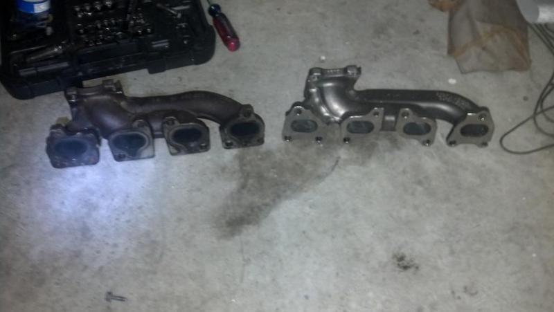

So here are some pictures of the manifolds together,
I also put the new oil lines on this evening but, forgot to take pictures of those so that will be tomorrow when I put the new manifold on and start with the meth kit.

I'm guessing the cleaner, silver manifold is the new one.
The holes in the new one look smaller and the two seem to be the same shape. The new one does look a little lighter. How is it supposed to give you any gains if the holes are smaller? Or is it just the pictures?
Old Jan 3, 2013 | 11:52 PM
  #41
MNIPWR's Avatar
MNIPWR
Joined: Apr 2011
Posts: 668
Yeah, Any chance you can measure them?

The new is the silver and it has smoother holes, better runners, and it is lighter.

See, my JCW already had the newer type on it. Thats actually the EU type of manifold. It gives noticeable gains if you are moving over from the US version.
Old Jan 4, 2013 | 09:29 AM
  #45
Porthos's Avatar
Porthos
iTrader: (8)
Joined: Feb 2009
Posts: 6,455
Likes: 14
From: None yours!
Ya I was one of the first to buy it but, it has taken over a year to find the time to install it.
