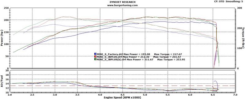

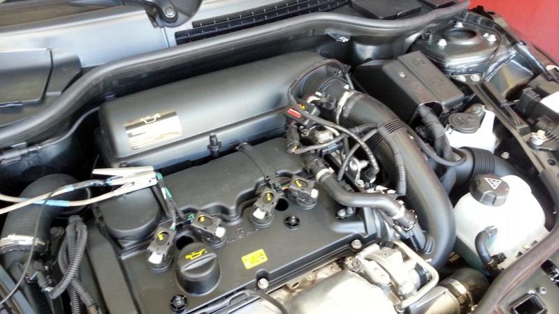

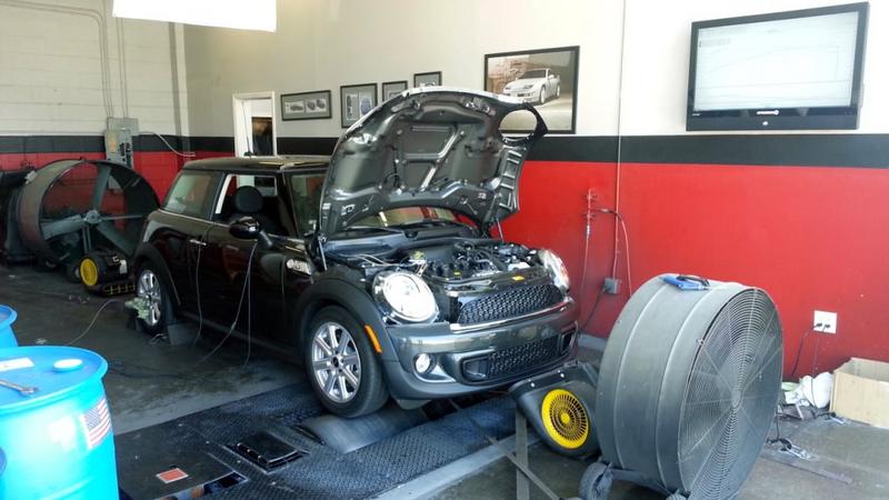

Was able to hit the dyno today with our test sled and the JB+ put up impressive numbers as expected. Fuel was 93 octane and temps were in the low 90s. Hit the 20whp & 30wtq+ figures on the nose.
Are the MINI_S_Factory #'s your stock baseline #'s? Just curious because that is way higher than any others baseline #'s that I have seen.
That was the best of 3 stock runs. Lowest was 188rw IIRC. The power delta between stock and tuned is the main thing to look at as all dynos will read differently.
Thanks. I understand that the difference between the baseline and tuned numbers are what is important but some people are going to see 255 torque and think thats what they have when they buy this. 30 torque over stock wont be anywhere near 255.
For comparison mine baselined at 172 hp and 184 torque on a dynojet. Thats 21 hp and 33 torque less than you showed. I know different dynos at different times will read different but that is a huge difference.
