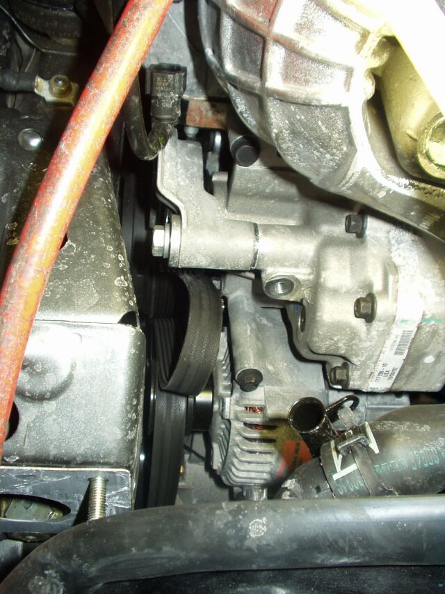

I used the stock belt with my 15% pulley for about 15k miles. Toward the end of that period, the belt began to squeal in the morning. It said "Soooo-Weeee". Then, it kept asking if it had a pretty mouth.
Anyway, I now have a nice fresh -25-060535 belt and no more squeal. The tensioner and the idler pulleys appeared fine - turned freely, no play.

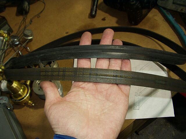

Here's what my belt looked like at 1500 miles with no mods:
Here's that same belt (top) after 15k of 15% pulley usage, compared to macncheese's belt (bottom) after 40k of stock usage.

[quote] Then, it kept asking if it had a pretty mouth.
A little more seriously, that is an interesting comparison. I'm at about 20k of pulley usage and haven't had any strange noises yet. Something to keep an eye one.

I'm not making a point, just showing pictures of belts.

I think that there are two issues here. The quality of the stock belt vs. the aftermarket belt and the wear rate on any particular vehicle.
Andy, your belt did look like crap but it was clearly worse than mine or anyone elses running aftermarket belts. Additionally, while significantly worn on the top??? the V area of the belt looked just fine and showed little sign of wear. Could it be that you have an idler pulley problem?
John mentioned that he was looking into higher quality aftermarket belts that will wear and stretch less. Has anyone else found such an animal that will fit our cars?
I had a 535 on my car with a 15% pulley for about 7,000 miles. It showed no sign of wear, nor did it slip, but it did stretch to the point that you could no longer see the top hole on the tensioner. I replaced it with another 535 when I put on the 19.
Let's source some high quality belts so that we don't have to replace them every 10k miles.

i was having a meeting in my office and playing with my old supercharger pulley while I was pretending to be interested in what my guest was saying.
The pulley is black and I noticed that the middle rib of the bearing surface where the belt runs is polished and seems to be slighly sharper than the others. This made me wonder if there is a flaw in the stamping/casting of the pulley which causes the belt to get cut in the middle (long axis) which leads to the failures some people have been experiencing recently.
There is no way to see this unless the belt is off but it would be worthwhile to consider next time one lets go. It would also be interesting to have Randy (or anyone else doing lots of pullies) check any they are taking off to see if they see any such wear pattern.

Well, after only 7k miles (about 5k of them with the 19%), my replacement belt is now glazed and squealing. It appears to have stretched, the tensioner bar is barely protruding above the spring, maybe 1/4". No holes are viible at all.
I have a spare NAPA 535 that I'll slap on for the time being, but I'd like to try the Goodyear belt or anything else that may not stretch as much.

If I recall correctly this specific question was asked a while back, and Randy indicated that the middle rib wear pattern is actually caused by the pulley removal tool, not wear from the belt. He said that the only way to verify this was to inspect the stock pulley prior to removing it with the puller --

Andy, back on the first pic...what is sketched out on paper on your workbench? :smile:

in my spare time (!) I build staircases; that is a sketch showing the cross section of a stainless steel curved stair stringer...the outer plates are 1/4 x 12" stainless plates, helically curved; they are assembled with 1-1/2" sq bar spacers to form a helically curved box beam. the top is set back to form a 2" deep channel into which a glass ballustrade is fitted. This was completely designed and fabricated in my shop and insatlled in a Manhattan residence; two flights' worth! A pesky project that kept me from my intercooler work!
