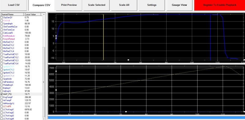

Here's a screen capture from a datalog, top is boost, bottom RPM, and as you can see from the engine temp, this was a hot day. (All the data on the left is from the exact point where the first yellow line is on the left of the top area, for those not familiar with the datalogger)
The two areas don't match up perfectly, the start of boost on on the top screen is actually at the 3000 RPM point on the bottom.

I don't see Inlet air temps anywhere on your log. Where your cursor is at its showing boost was 11 psi and 3000 rpms. It was pulling timing also. I still would like to see some relevant data that proves what you claim is true. All the data I have seen by actual customers posted online shows them to be extremely hot with the smaller pulleys. Which stands to reason using sprintex's own blower calculator. You might want to go back and see what the temps are at 3,000 then move your cursor to 7000 and show those numbers. I think you will be surprised when you see the data and fully understand it.

Here you go, here's the values at 7000, I've even lined up the graphs on this one, and as I said, consistent 20psi.
And before you start screaming about values, this is actually an old and very early tuning log, before GPIC, and far from being done, all my later logs are packed up as not only am I getting ready for MOTD, but packing everything to move, so I won't be able to get to most of my stuff for awhile. (The whole moving thing is also why the car has been sitting for so long, not only did I not want to misplace parts, but the car had to remain portable also. Should be able to get back to my rebuild some time in June)
