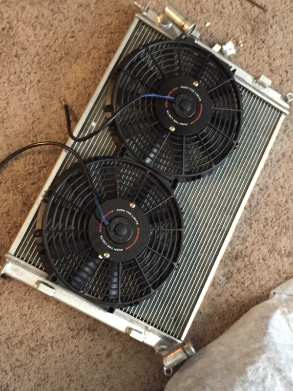

Originally Posted by RonRob
Yes it is quite tight indeed. However the inlet appears to sit below the tubing in picture one. Still seems like ample room. That is unless the inlet sits on top of a non removable part. Thank you for your insight Ron
It was tight, slim fans solved that. Replaced eleptical inlet plate with a round inlet an made a silicone straight shot inlet. My jimmy rigged showed a 40-50% increase flow over stock inlet. And the bump in power was obvious now the poor thing can breathe
