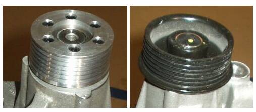

Caddman,
Why don't you have your pulley guy corner the market on black steel 0% pulleys. Make one identical to the item on the right and I'll buy one:

From: NY NY
the bore size on the original P&D heat-fit pulleys is precison honed to within .0001" (one ten-thousandth) of the stock pulley bore size. That would indicate you could heat fit the stocker and slip it on the same way as the P&D heat fit. good luck on the paint holding up.
the P&D puller does not mangle the stock pulley and there must be hundreds and hundreds of good stockers out there
