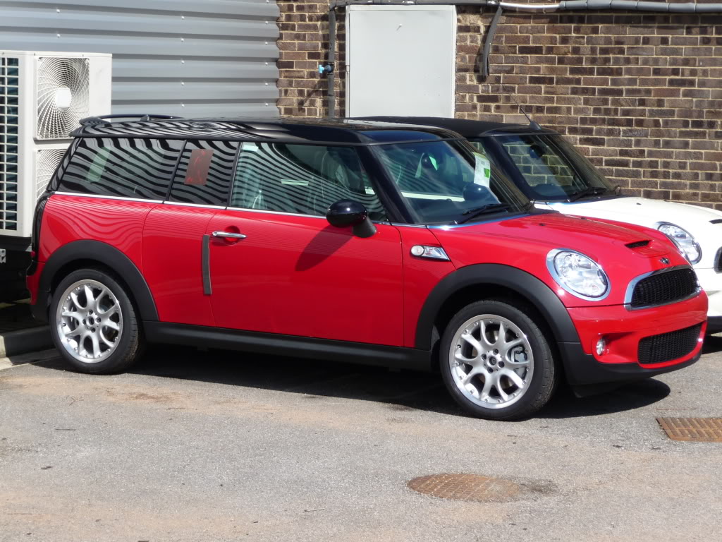

Good for you, I don't have an R56, I actually drive this on a daily basis, my R55.

looks pretty worked
