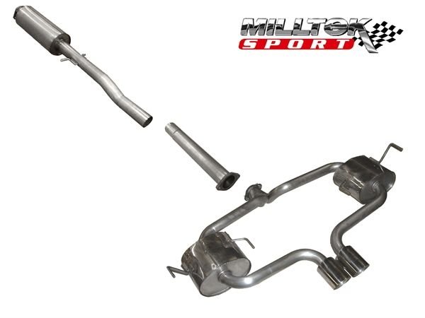

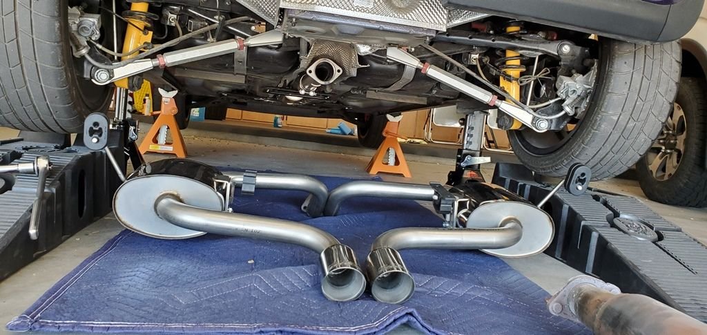

Bringing a really old post back from the dead...will a Militek exhaust that is currently on an '05 R53 bolt into my '02 R53?
Old Jul 9, 2021 | 04:19 PM
MCS4FUN's Avatar
MCS4FUN
Joined: May 2016
Posts: 1,409
Likes: 577
From: "The Other Arizona"
^^^ Likely so (depending how old the donor Milltek system), however you'd need the "other" pair of rear muffler/silencer hanger rods Milltek furnishes with their R53 systems. By that, Milltek welds brackets with threaded studs to the inside points on those with one set of furnished hanger rods attached to those being for pre-facelift R53 and the other set being for facelift such as on that '05 R53 (and my own '06 R53). Check that donor system to confirm same as shown on Milltek's website. I kept the unused set of pre-facelift hanger rods which I could ship for cost of postage plus some $$ covering time and hassle-factor. Also have some OEM hangers currently advertised in forum classifieds.
Edit: add'l pics added if clarification is needed: 1st one shows Milltek with rods and hangers ready to install and 2nd one the unused hanger rods for pre-facelift R53 such as your 2002.
Milltek R53 exhaust systems and parts
