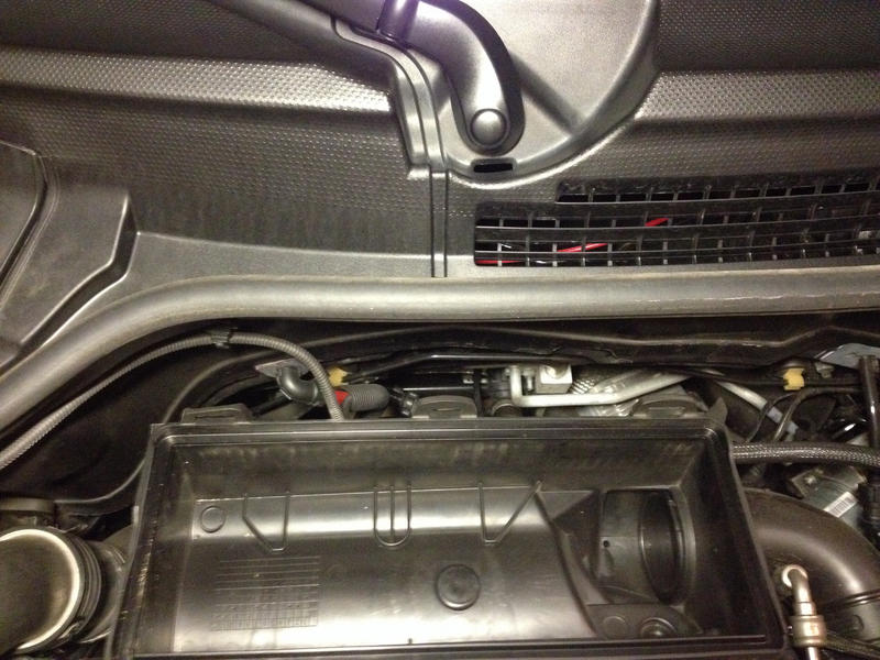

2012 MCS OEM without noisemaker
So I was driving a 2012 MCS dealer loaner and it was unusually quiet. So I popped the hood and it was noisemaker-less
The previously posted photos of the OEM noisemaker-less mini did not work.
Here are 10 photos and a 39 second video.
https://www.dropbox.com/sc/yxhehwy601iln9k/Nr4v7OgeO0
Attached Thumbnails R56 Noisemaker Revealed!-2013-09-26-20.51.35.jpg   R56 Noisemaker Revealed!-2013-09-26-20.51.45.jpg   R56 Noisemaker Revealed!-2013-09-26-20.57.17.jpg

I am having trouble understanding the cowl space. Does water get in there when it rains? It that where the A/C gets air?

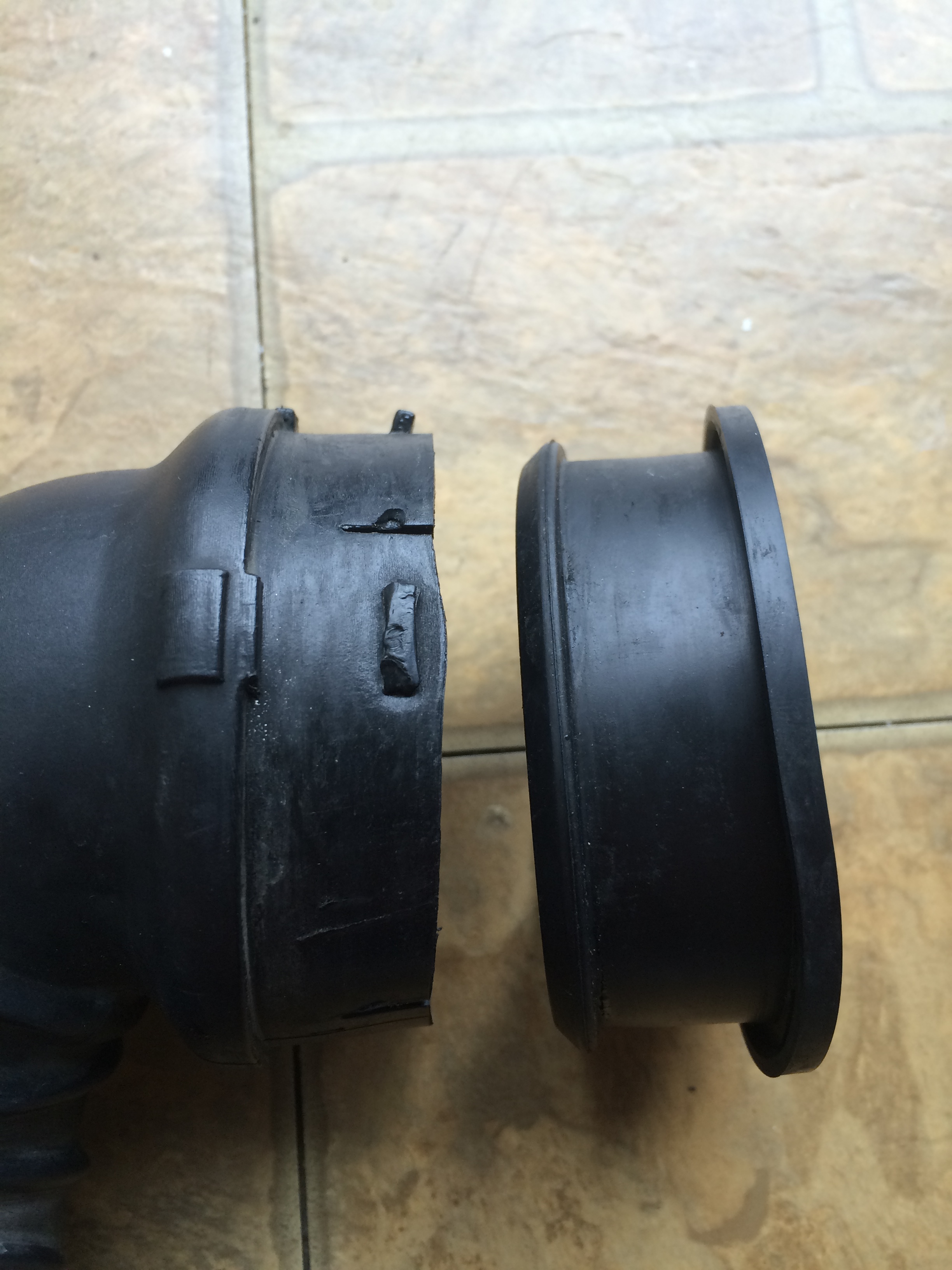

In March about 9000 miles ago the evap drain was cleaned and heater core replaced by the dealership. After that I have done oil change, air filter, cabin air filter, front and rear brake pads. The Manic stage 1 tune has been on since November 2014.
3 weeks ago I drove from Dallas to Los Angeles. A few days ago I was motoring on 118 heading west and heavy on the throttle above highway speeds the hose came off. It was 107 outside and I was on an uphill section of the road. I believe my driving style is very stressful to my car so... just sharing my experience.
The codes:
Fault: :Mass or Volume Air Flow “A” Circuit Range/Performance – Air Flow Too High- Code: P00BD
Fault: :Interface EWS-DME: Hardware error- Code: 0032E3
Fault: :Lambda probe after catalytic, electrical open circuit lines / Air Mass- Code: 002D22
Fault: :Engine cut off time / Cyclical monitoring Fehlerabspeicherung / unknown failure / Air mass plausibility: air mass too high / Misfiring in shifts- Code: 002774
Here are a couple of pictures of the failed hose. It just not as robust as the original hose with the noise maker. It just simply slipped off. Either it was damaged by the tech working on my car or it failed. I used the clamp on the new hose that is why it isn't in the picture. The left picture has the rubber gasket inserted into the plastic hose.
After replacing the hose the CEL turned off by itself. Did some data logging and everything seems normal.

Yea, first I have heard. Looks i little mangled on the plastic side from install or over-tightened the worm clamp from the tech is my guess.
