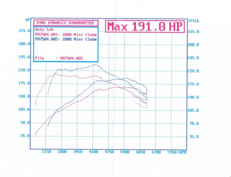

Here is the graph. It's actually at 221.1 and just shy of 250 tq at it's peak and for some reason, Jan says all JCW go up, dip and back up... not sure why but anyway, here it is.
Not quite what I had hoped for graph-wise, not numbers wise but nonetheless....

Nice numbers, Mark. Was this a dyno at the wheels rolling or bolt to the MINI?

Don, that was a dyno at the wheels. Have fun at the track. I'll talk to you later.

Mark, my R56 pulls 205WHP and 238WTQ with a DDM CAI on a DynoJet.
Popular belief is some dynos report low and some high, but it is all about repeatability on the same dyno. There are some old thread here on NAM about the different results on each type of Dyno.
It is how it performs on the track and 1/4 mile if your into the 1/4 mile stuff.
If your happy and can feel it in the backside, then good results.

DAMN man... that really sucks. I mean, great numbers for you but if I'm at 250 tq with a JCW AND intercooler AND CAI AND downpipe AND full exhaust AND you're in an automatic, how in the hell did you pull only 20 less tq than mine?
Either....
a) Milltek's exhaust is better than everyone knows.
b) you've got a freak.
c) mods don't make a difference.
d) JCW don't make a difference.
e) I need another tune.
f) Mine is a POS.
Hmmmmmm, I wonder...lol.
Glad you turned the numbers you turned but in retrospect, for another 20 ft lbs of tq, why spend an add'l 6-8K in money.

I spent money like you did and here I am still spending, swapping parts to get the best combination. I have a JCW air intake (from the tuning kit) and Alta foam filter on order to see if that works out better
The tune should be able to compensate to get more out of everything but maybe bigger fuel injectors are needed as well? I am eventually going to get the tune and these will be questions I ask RMW beforehand.
Well, I did ask Jan if he had a tune for the JCW and I was assured that he had one. (which he did)
After 2 hours on the dyno, (the hotside tube came off twice... once during that 2 hour period and once at the end)
I'm not real thrilled with the outcome of this tune. It's noticeable but there are guys running 230-240 wtq with stock JCW.
Guess I'll have to wait until someone has a better grasp on the JCW.
My mods aren't that extensive. DDM CAI, full exhaust and Forge intercooler.
I'm not real thrilled with the numbers.
Sooner or later a tune will be available for the JCW cause for 725 bucks, (that was after Jan deducted 100 bucks because he wasn't happy with it either) it wasn't worth the money.

In my opinion, your numbers aren't as impressive to you as they should be for the following reasons:
-The JCW stuff probably WORKS. You changed the full exhaust and intake, which in my opinion, JCW actually did it right this time around. I'm convinced the JCW intake is the best way to go. And looks like the exhaust isn't so bad either. Changing on all this stuff on a JCW doesn't make sense, cuz the JCW is basically an already modded version of the Cooper S. So you're just changing from one aftermarket part to another essentially. And the only thing I see remotely helping you is your aftermarket IC, and with that...I have heard not such good things about the Forge.
-The JCW is already maxed out, so the gains are going to be less. A lot of the gains in a JCW over a stock S are probably in the ECU, along with the above parts. So it makes sense that you're not seeing much higher numbers than a lot of the other "stock" cars. Remember, the JCW has the same engine as the Cooper S...sure some of the internals are forged but that is not going to give you more power.
It's a shame you don't like the tune...you're the only one that I've heard of, everyone else that I have spoken with that has it is ecstatic about it, myself included. However, you are the only one with a JCW...JCW's are already fast as it is. Your gains are not going to be proportional to the gains everyone else is seeing sadly.
