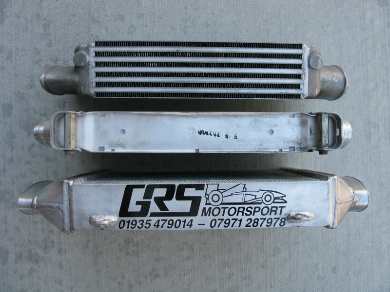

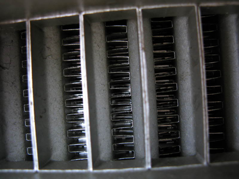

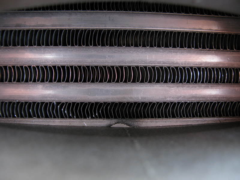

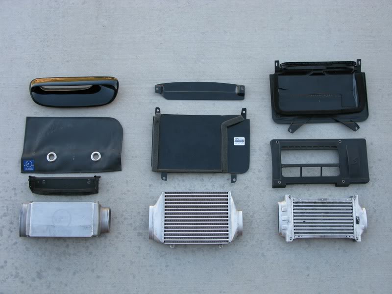

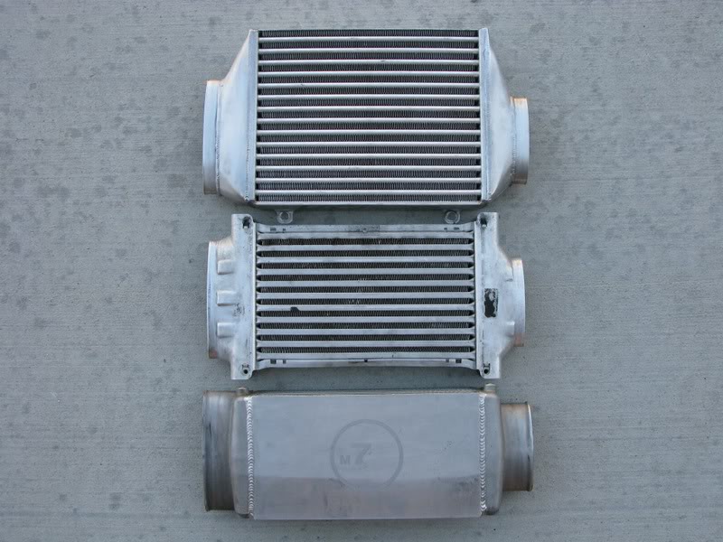

I drive my car on the street and I posted this review on our local club boards. I figure I'd throw it up here for those that are interested.
Ambient temp the day I tested these was 81 degrees fh
*******Begin Cut and paste********
Ok, I had the opportunity to test 3 intercoolers over the weekend and thought I'd post my opinion on them. I tried all three complete set ups on my car. I did this trying to figure out if my pinging was intercooler related.
I found out that it was not however, it was worse with some over others.
M7: The car has a mild ping
GRS: The cars ping was slightly more pronounced over the M7
Stock: The car pinged WAY worse, my engine sounded like a pinball machine 8O Interesting!!??
Keep in mind that I didn't dyno the car with each of these, or run measuring equipment of any sort. I ran the car for about an hour with each intercooler on the car on the same roads. I used my seat of the pants measurement technique as the only means to draw my conclusions.
I tested the following intercoolers
M7 DFIC version 2 (I have the areogel blanket as well)
GRS Motorsports
Stock intercooler
M7 DFIC: Included Items
Intercooler
DFIC Hood Scoop
New intercooler boots
New clamp hardware
Front air tunnel
Sealing foam, instructions etc.
Price $899.00 ($100.00 for the Areogel Blanket)
The M7 DFIC Intercooler happens to be my favorite and is going to stay on my car.
There are several things about this intercooler that I love.
The materials, fit, finish and packaging were top notch. Very easy installation, everything fit and went together flawlessly.
The version 2 dfic is smaller and redesigned to increase boost. The lightweight aluminum and size allows for quick recovery from heat. I feel like the cooling effectiveness is increased by having the air flow directly thru instead of having to take a 90 degree like the other intercoolers.
While driving, the M7 intercooler was more responsive off the line and thru the RPM range. It constantly felt strong and the car pulled hard from stop to redline consistantly.
After hard driving I pulled into my garage and immediately popped the hood and felt the intake and outlet horns. I also felt the intercooler temp. The intake horn was extremely hot and I couldn't keep my hand on it. The outlet temp was hot but I could keep my hand on the horn, it wasn't hot enough to burn me. The intercooler temp was hot hot on the intake side and the same temp as the horn on the outlet side.
GRS Motorsports: Included Items
Intercooler
Hood mountable air diffuser
Scoop mountable air channel
Foam
Price $700.00 plus shipping from across the pond (Not sure these can be purchased in the US currently)
This was my second favorite intercooler. I think this intercooler would greatly benefit from having a larger scoop like the M7 Ram Air or Extreme scoop. It is set up to use the stock scoop. Putting a larger one on I know would greatly improve the cooling and performance this intercooler could provide.
The fit, finish and design of this intercooler is truly amazing. Looking at the thing and the way its build screams "Holy crap! I'm something!" The interior core design and the way the air flows thru unobstructed (well almost, talk about that in a second) is very very pretty. There are virtually no interior "air tubulators" in the interior of the core. This allows this intercooler to be as large as it is and still retain boost or "pressure".
Ok now, one drawback to the interior design is the way they designed the "air channels". The actual interior airflow pathways are raised and the exterior air pathways are recessed. I can only imagine that this will cause some issues with turbulent airflow. I think they should have at the very least designed these to sit even with each other (See images)
The GRS seemed to have slightly less boost than the M7, not quite the oomph and raw power. It was really smooth thru the rpm range and the power delivery was smooth and constant. I also had the Alta top mount on my car at one point. I would compare this intercooler to the Alta except the GRS has more boost. I felt more power with the GRS than the Alta but not as much as I did with the M7 DFIC.
After hard driving I pulled into my garage and immediately popped the hood and felt the intake and outlet horns. I also felt the intercooler temp. The intake horn was extremely hot and I couldn't keep my hand on it. The outlet temp was hot, almost hot enough to burn me. I couldn't keep my hand on it. The intercooler temp was hot hot on the intake side and the same temp as the horn on the outlet side. Again, I think this intercooler would perform waaaay better with a larger hood scoop feeding it more air. I think it would keep the temps down and this intercooler would shine.
Stock Intercooler: Incuded items
YOU HAVE ALL OF THEM!! If you don't call Levi! 8O
Ok, I felt like this intercooler performed the worst out of them all but not horribly so. The power delivery was smooth and constant thru the rpm range to redline. Throttle response was quick and good. The only thing I noticed was the car just felt more "sluggish" than it did with the other IC's.
I'm guessing that this IC would benefit from having more air run thru it as well. All IC's will benefit from larger hoodscoops. More air equals more cooling which equals more power!

This picture is of all the contestants and most included items
Top of the intercooler surfaces
Airflow surface
Intercooler thickness
M7 DFIC Interior core design
GRS Motorsports core design. As you can see the air channel surface is raised. It's my opinion that the flow of air would benefit from being recessed or at the very least being flush. The second image is of the sun shining thru. Nothing to impede the airflow in this thing. Very cool!

Stock interior core design. Having the intake channels pinched together for better airflow is a very cool design. I wish the M7 had these!

Not having a DFIC v.2 myself, and it's kinda hard to tell in this pic...
...but are the tubes facing the ambient air flow rounded?
Kinda like what I did here to my v.1...
...and here on the inlet side...
...would be pretty cool if Peter incorporated the rounded tubes on the front face.
https://www.northamericanmotoring.co...ad.php?t=89499
