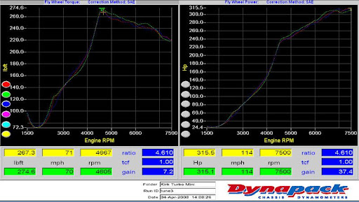

Originally Posted by JIMINNI
So is this thread signaling the end of the Rotrex? If someone is going to modify their car to this extent, "non-turbo to turbo"/ M45 to Rotrex, why not go to just a turbo? They seem to produce more output than the Rotrex. Plus, either way they won't pass a visual smog cert. in California. I am getting completly lost in all this engine mod. stuff . I still don't understand how these cars will pass smog here in California . My gosh, they say my Alta intake wont pass . PM if you have any info. to share .
They each have their merits. While the turbo only route will eventually provide the highest level of PEAK HP, the Rotrex is going to have a much more "Streetable" curve.
Did you see where this car is making power? It's all in the upper (4000+ rpm's) power band. Great for the track, or if you drive around in 3rd gear all day, but on the street, having 75 HP until 4k RPM's is not only dangerous, but boring.
I don't think the goal of either of these kits is to pass CA Smog (Though it'd be pretty hard to tell what's done to the car with the rotrex, it looks basically stock).
Most of us have figured out by now how to get around issues with smogging our cars. The law's are complicated, but here's a posting directly from the CA DMV Site regarding smogging your car:
Cars Six Years Old and Newer
If your vehicle is six years old or newer, you will be charged an annual smog abatement fee when you register your vehicle, rather than being required to provide smog certification.
Exceptions
The six-year-or-newer rule doesn't apply to nonresident and custom-built cars made since 1976. Those vehicles require smog certification. If you have a custom or specially constructed car, however, you might need a different type of smog certification.
Title Transfer and Smog Requirements
When you sell a vehicle that is four or fewer model years old, a smog certificate will not be required in order to transfer the title. The buyer will pay a smog transfer fee of $8. If the vehicle sold is more than four model years old, the seller must provide evidence of a current smog certification except in any of the following situations:
The vehicle transfer occurs between a spouse, sibling, child, parent, grandparent, or grandchild.
The vehicle was registered and biennial smog certification was submitted to the DMV within 90 days before the date the title transfer took place. A vehicle inspection report may be required for proof of certification.
So I don't have to worry about smogging my car until 2012, and if I decide to sell it, I don't have to worry about that until 2010.
Even if either of those dates passes, like I said, it's NOT that hard to get your car to pass smog . Jan's 2.0 Stroker kit passed with flying colors!
just for clarification, this is comparison of turbo only dyno vs. stroker with stk pulley and danny's monster. really apples to oranges, but gives you an indication of the different stages of components and range of power.
at 3000 rpm whp/tq
danny 100/175
stroker 120/205
turbo 80/140
at 4000 rpm
danny 148/192
stroker 162/212
turbo 150/190
at 5000 rpm
danny 182/192
stroker 208/215
turbo 250/263

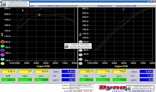

I know it's in here somwhere, but what does Danny's car have in it for power?
Old Apr 9, 2008 | 06:09 PM
  #211
Guest's Avatar
Guest
Joined: Aug 2005
Posts: 3,902
From: SoCaL (Agoura Hills)
Laminova W2A IC
RMW "Jesus" head
RMW Full Exhaust (With header)
19% Pulley
Schrik Cam (Doesn't really do anything)
K&N Typhoon
RMW Tune
Forged Pistons (Safety not power)
