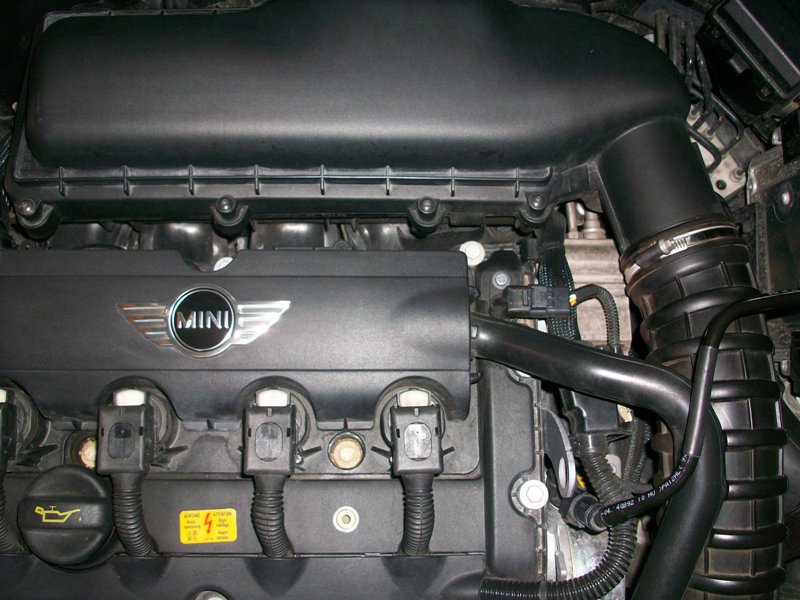

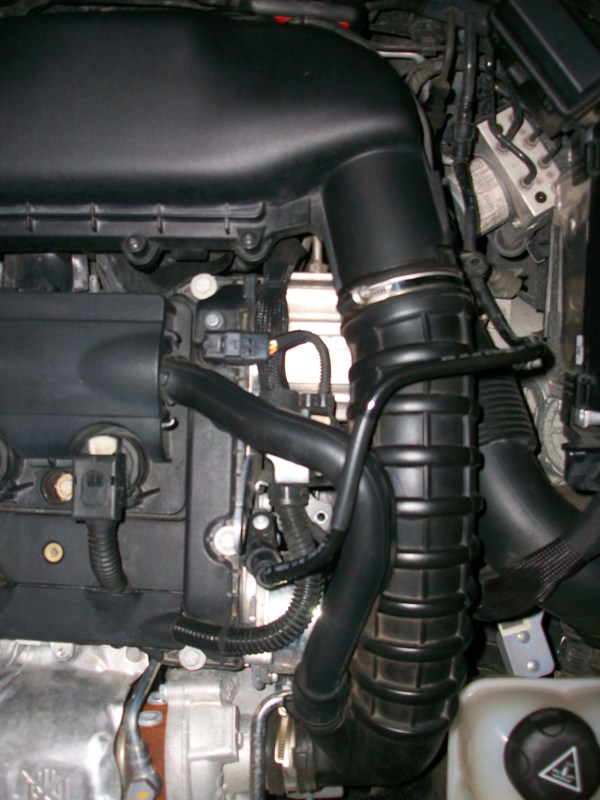

yo adam. im gona buy alta cai for my car but i just saw the instruction PDF and it seems that my car is different than the one in the picture.
here are some photos, please tell me if the cai u have online is good for my r56, or is the another version for my car.
(ps my car was bought in mexico, and i think it is the european version)
Attachment 40782
Attachment 40781
you do not have the MAF that the US version does.
