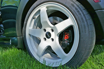

All's well that ends well. Wilwood fronts and TCE rear kit on and tested.
Eddie07S: I tried to take a pic of the TCE rear kit for you but it's hard to get light in there. It uses the OEM brake, a Wilwood hat, and a big Wilwood-style rotor manufactured by a TCE partner. It's probably is as much for show as performance.

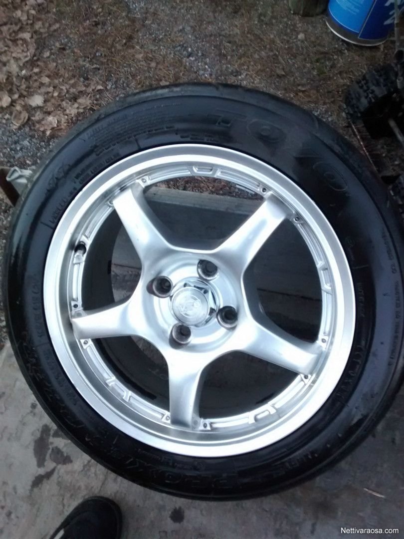

SDriver: What make/model are those 17" wheels I said I didn't need?

Beyond appearances the value of a rear kit is proper brake balance with the big front rotors and also the added thermal capacity that you do not have with the stock rotor when needed for open track day use

Does the extra leverage from the brake being farther from center make a big difference? I can tell you one thing — when I slammed the brakes to bed the pads the car was almost at a stop while the speedo was still reading in the 20s. That's a quick stop!

BSA type 345's in 17x7 with 215/40's mounted. All black.....not silver like the pic.
