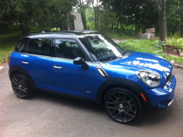

20's fit nice
After three orders, two cancelations and way too much time on the phone with wheel/tire techs, I got my baby some twenty inch shoes...
Attached Thumbnails Wheel fitment question...-img_2149.jpg   Wheel fitment question...-img_4516.jpg   Wheel fitment question...-img_4514.jpg

Looks good!
Any rubbing issues anywhere? What tires? Are they run-flats? How's the ride and what did you take off?

No rubbing. The new 20" setup is nearly the same overall diameter and 225 vs. 205 width. I'm using Hankook 225/35/20 Ventus V12 non-runflats and the ride is stiff but still softer than the stock runflats.

What brand are your wheels, they look great, however I think you need to lower it a bit.

They're 20" TSW Nurburgring in matte gunmetal.
I was expecting the height to be way taller with the 20s, but it ended up sitting just right for me. I like the height. I live about 70 miles north of NYC and the roads can get nasty (rough roads, potholes, gravel/dirt roads) Any lower might turn out to be a nightmare. The thin rubber is a bit scary, but after a few decent pothole dives the wheels remain unscathed...
