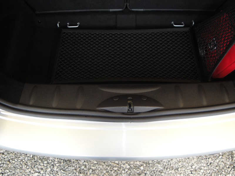

That is the correct lamp I am talking about but if I'm not mistaken there is a hard black plastic cover covering almost all of the rear underneath. I'll have to take a picture when I get home from work and post it. It must come off to get to that lamp.. lol. I remember this because when I use back to black or armorall, I sometimes shine it as well..nothing like a shiny hiney!

Attached Thumbnails Fog light centre bumper 2007 mini cooper-mini-cooper-1.jpg   Fog light centre bumper 2007 mini cooper-mini-cooper-2.jpg   Fog light centre bumper 2007 mini cooper-mini-cooper-3.jpg

I was just thinking that , you have the rear panel in place.
Underbody paneling, rear
http://www.ecstuning.com/Search/51711149159/
Just undo the plastic expanding nuts which is number 3 in the diagram across the bumper, pull the plastic down a little, reach up and pop the rear lens out. If you cannot band it enough undo the other #2 platic nuts toward the front of the MINI further under on each side , then the whole plastic should drop.
