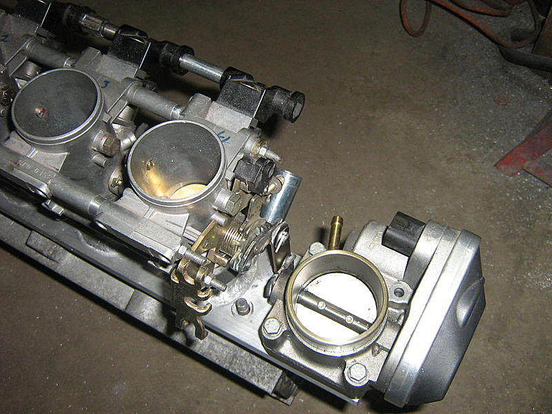

Hi everybody i,ve been here for a while because of a lot of things to do on my cooper here is some pictures of the work done . I think this might interest some of you stay tune for more pics

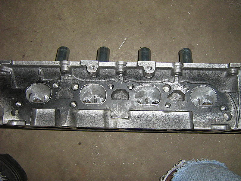

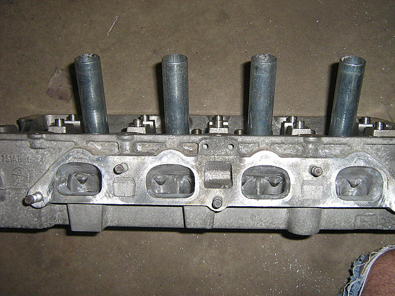

More pics
See the small linkage between the fifth cylinder TB hahahah.
Throtles are fro GSXR10000 2002

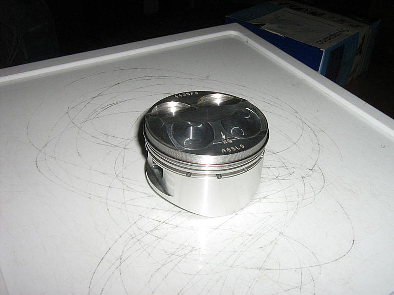

Pistons from GSX1100 86-88 Wiseco
Rods will be Acura B18b
Cat CAM
Jackson racing headers
Eric Courchesne

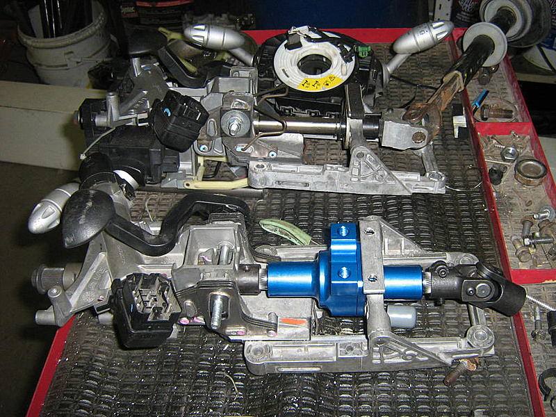

I also installed a steering kwickener for Snow and dirt conditions
The tilt steering is still working

first, the compression ratio was to high 14.7:1 we had to install 2 .95 head gasket to reduce to 12.6:1 by that way the head rised up so i had to grind the key hole in the cam gear to keep the cam dialed and i also installed a 2nd gasked on the plug for the chain tensionner because the chain was a little to tight .

First rally was the next week end so i decided to try remove the Cam and replace it with a Cooper S stock cam....Still limp. so i went back to stock intake to go racing but surprise, the ports have been enlarged so much that the rubber gasket was in the ports so i had to fill the groove with epoxy and install a composite gasket.

For you who want to know more on the kwickner the steering is now 1.5 turn lock to lock.Cool on ice and gravel but to tight on Tarmac .
