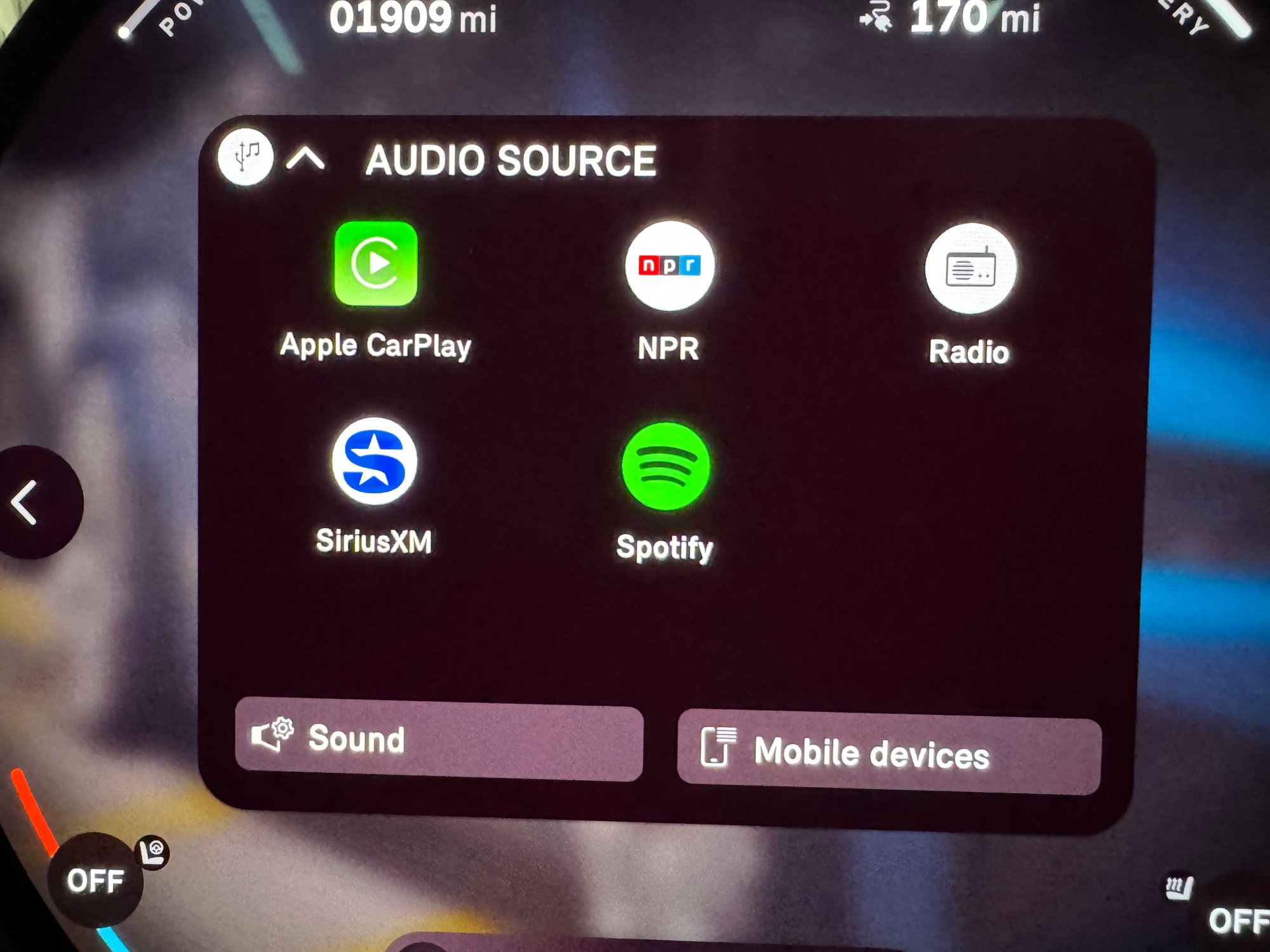

My 08/24 production U25 SE has no USB data port hardware, thus no USB audio source possible. All USB ports are for charging only.
Expected USB port - power and LVDS (data) connection
Front USB port in my U25 - power connection only
Owners manual (7/2024.38 and 7/2024.40) shows that this USB power-only hardware is correct for the SE (no USB audio), and OEM schematic confirms that this hardware change was performed from 07/2024 U25 production - no USB data ports (A519) from July-on production:

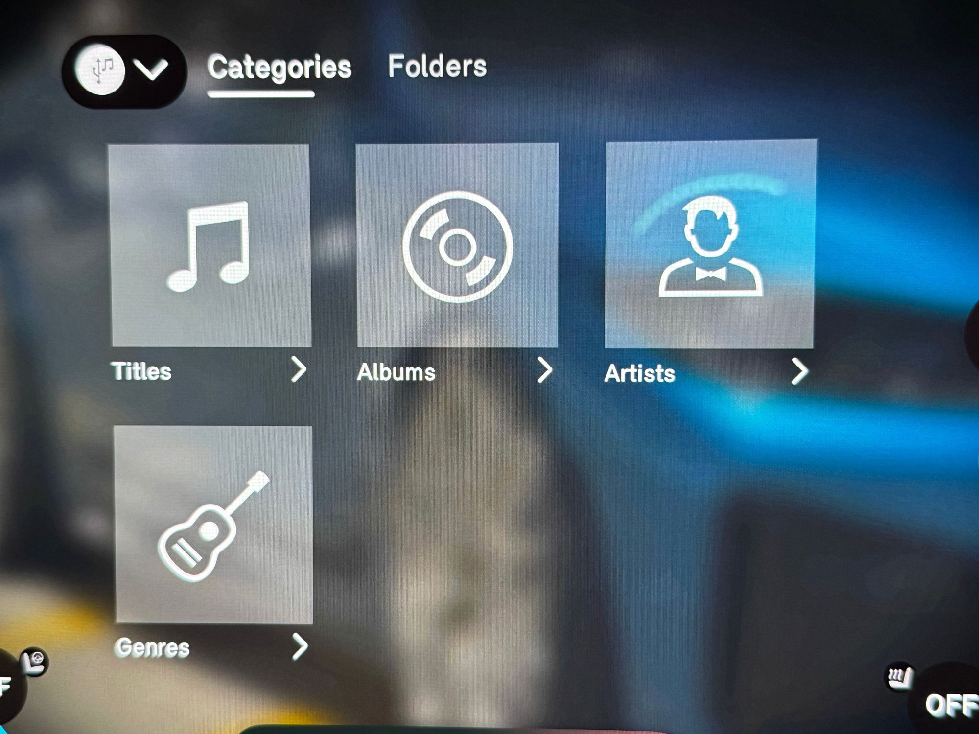

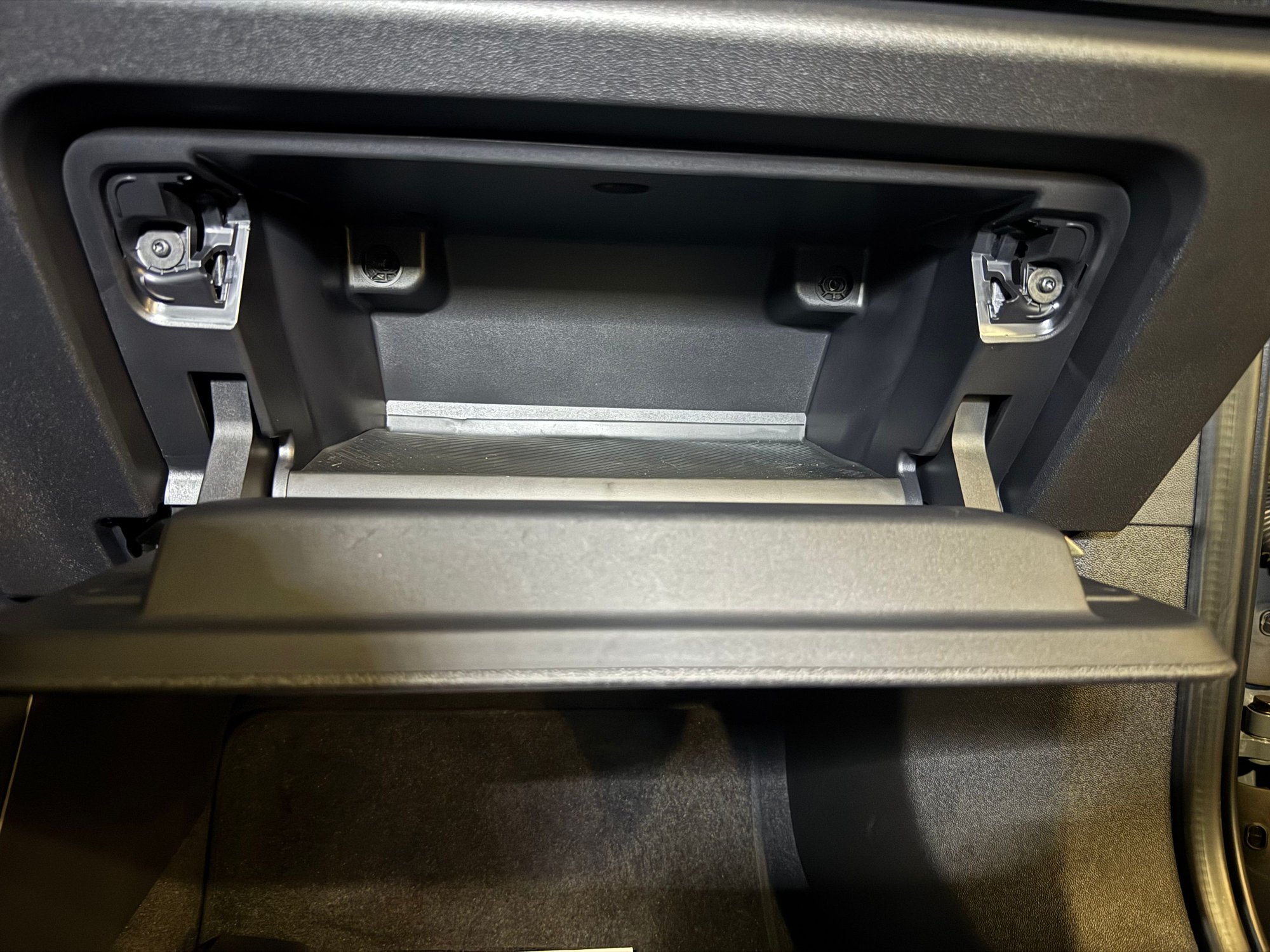

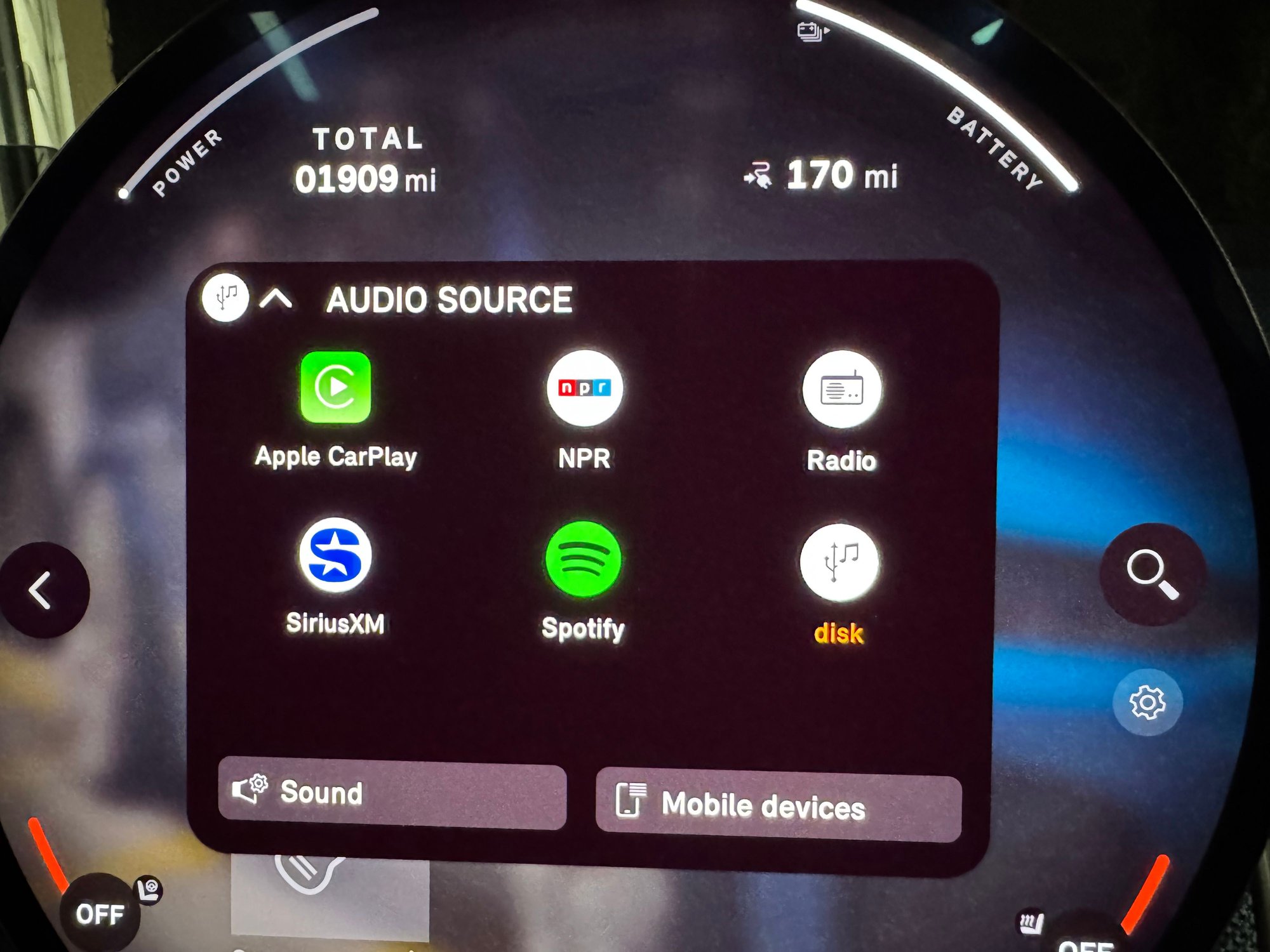

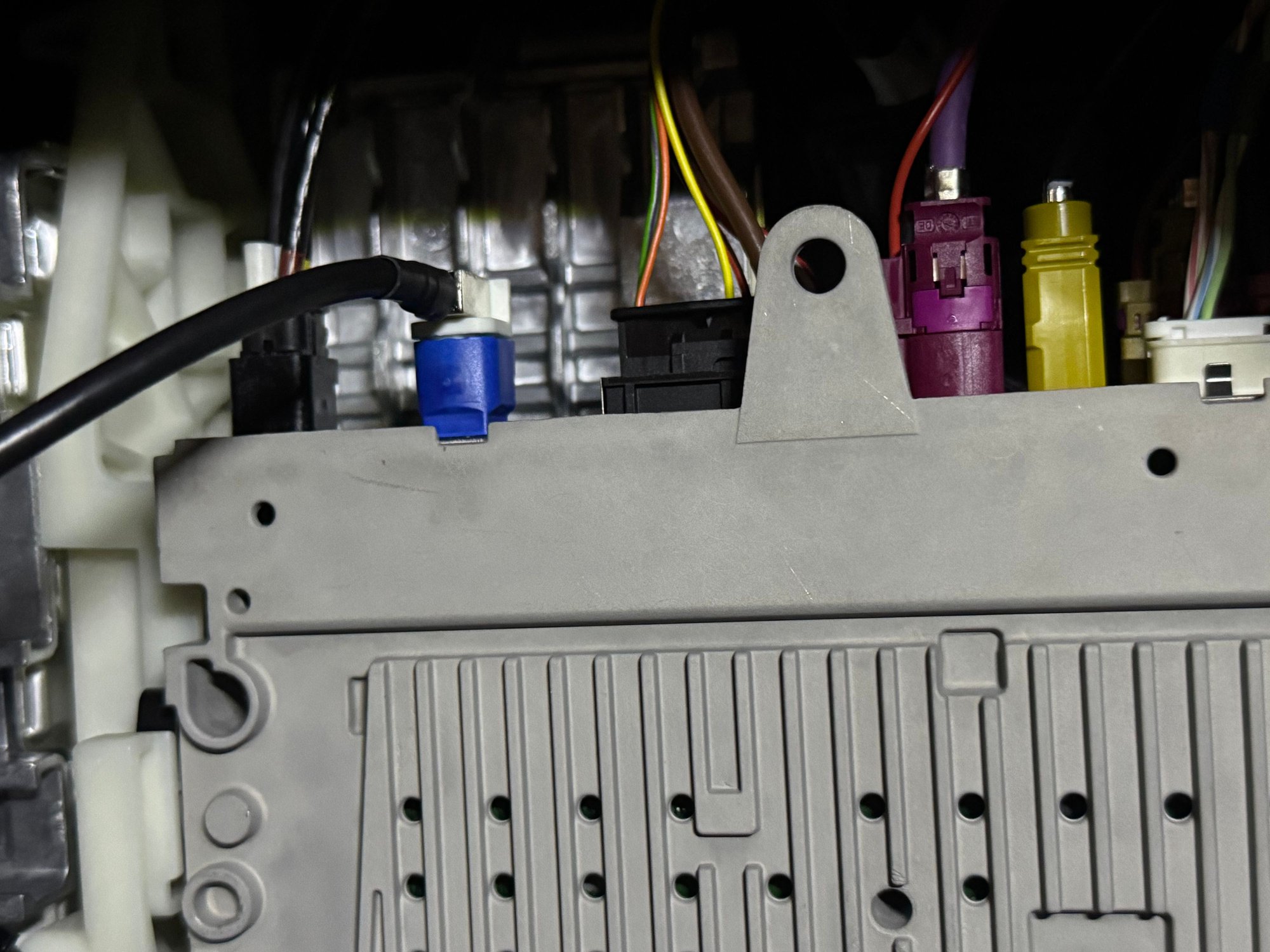

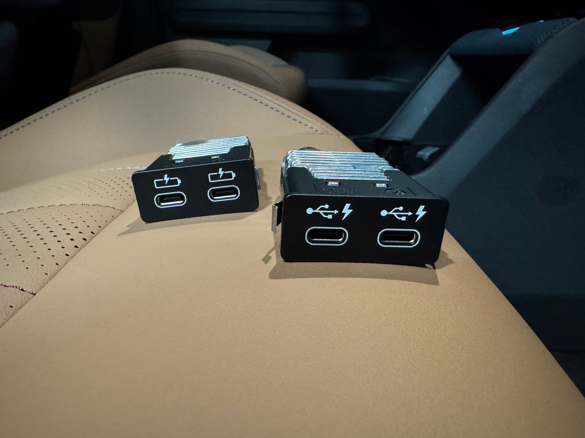

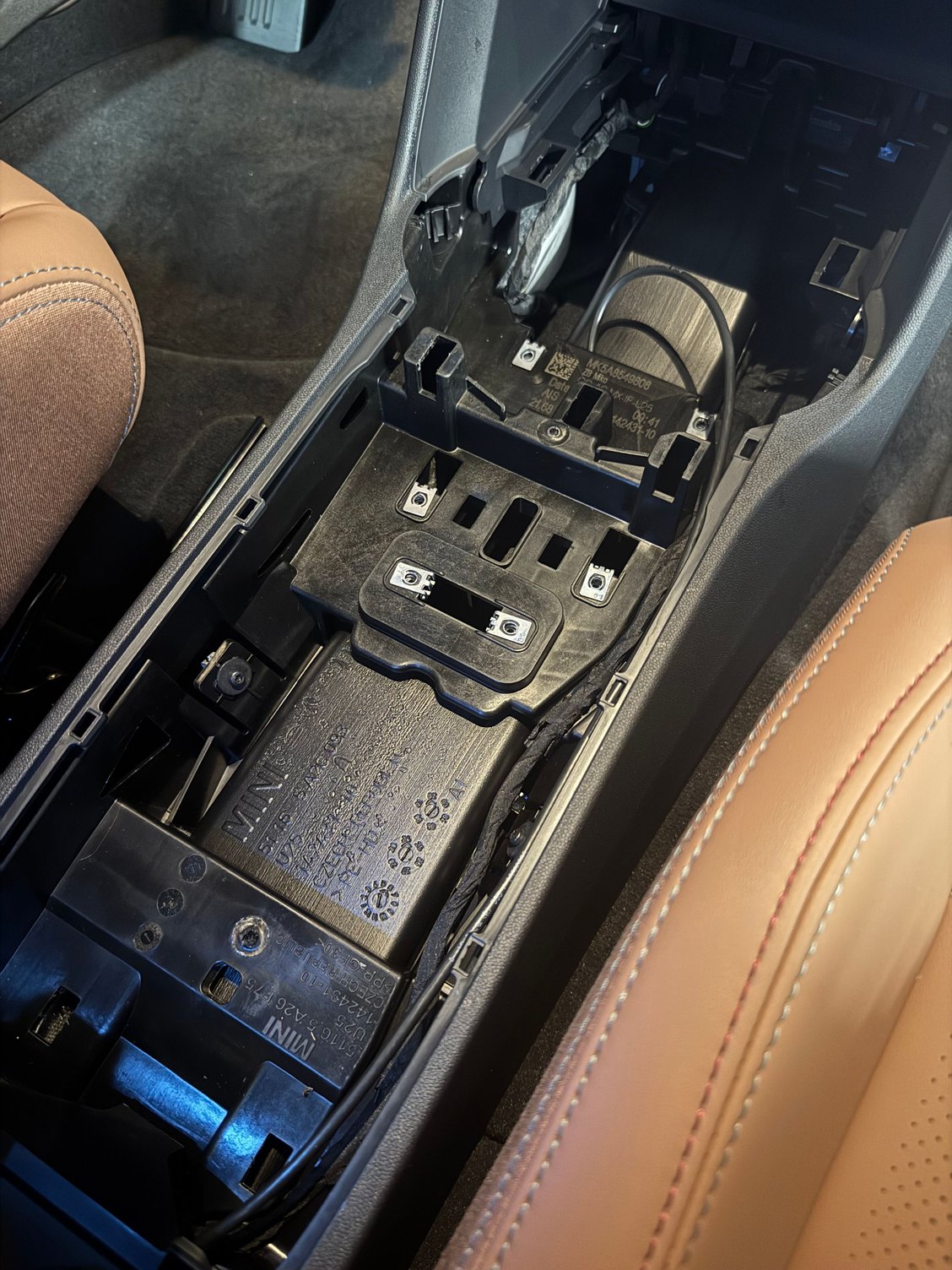

Let’s retrofit USB audio for 07/24-on U25 in 5 plug and play steps:
- remove center console trim, and glovebox
- plug LVDS cable into OEM HU USB port
- run LVDS cable from OEM HU to center console
- replace power USB ports with data/power USB ports (84105A57B32) in center console
- plug LVDS cable into data/power USB port
USB audio fully functional.

Wow this is very impressive work!
That's the only part needed? I.e., it includes the cable?
If you have an iPhone or iPod, can you please see if the OS9 will read playlists?
Many thanks for doing this!

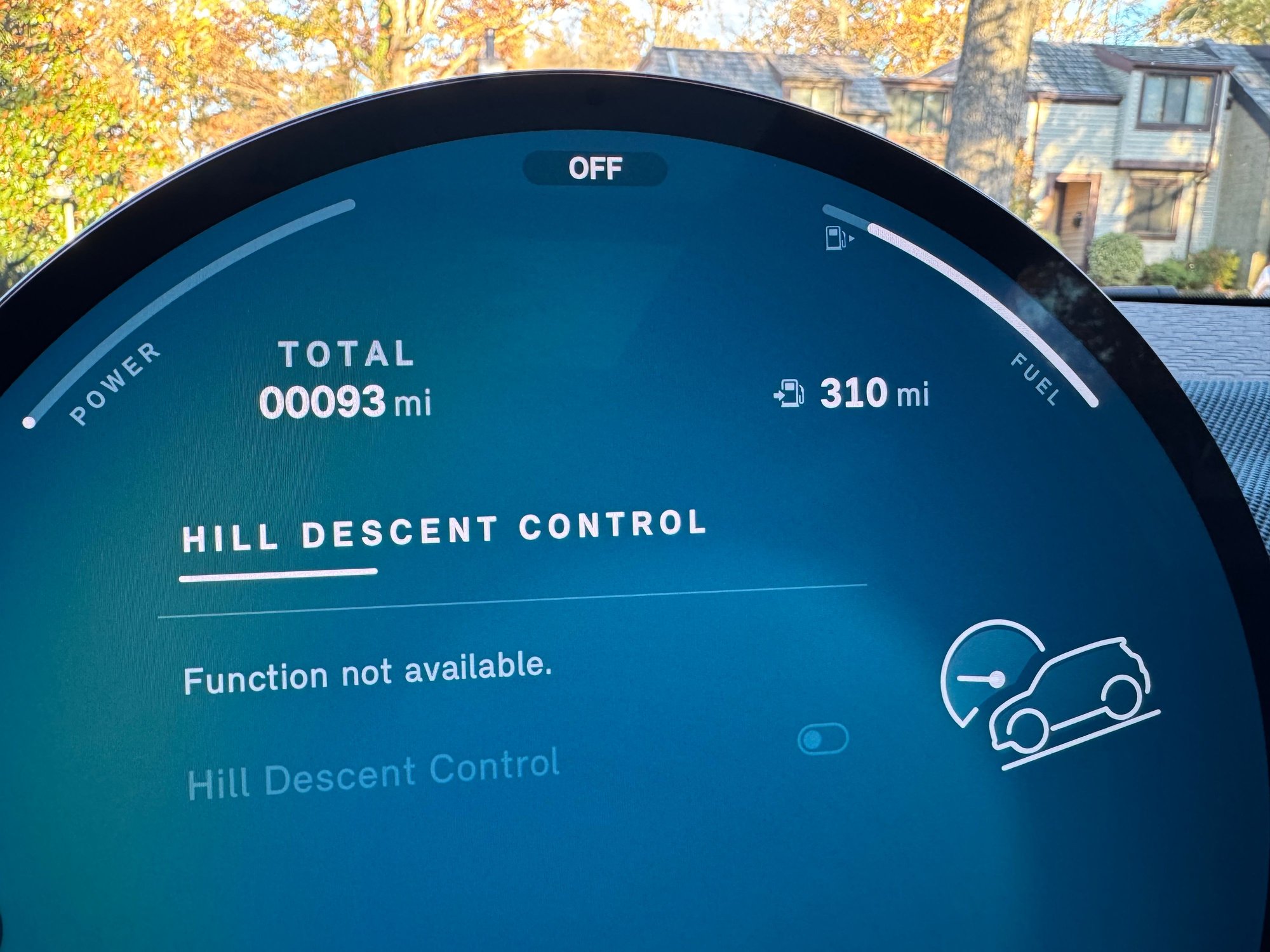

Anyone know why Hill Descent Control isn’t available? Shows up in the menu but can’t enable it!

LVDS cable (2m) : HSD A F to B F90
https://a.aliexpress.com/_msRrExm
iPhone does not connect to this OS9 as an audio device.
I had to pay to activate.
UGH. I was hoping it wasn't paywalled or subscription-based. (

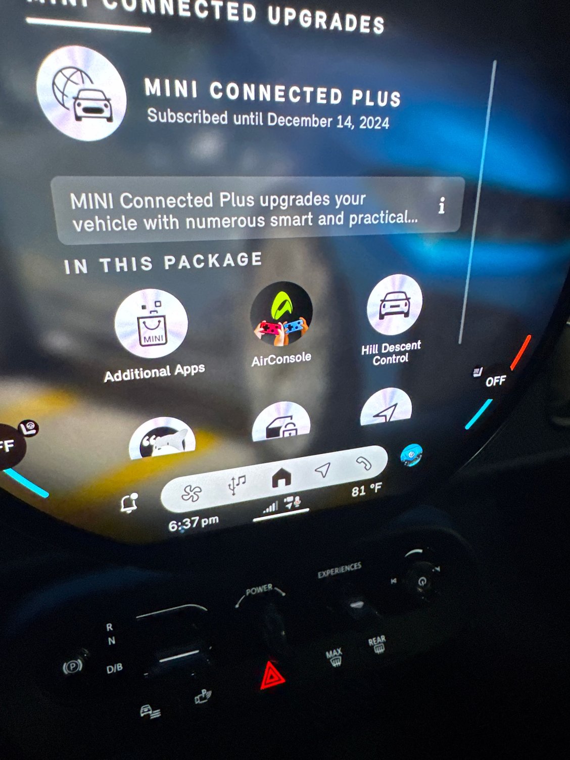

Subscription should be shown at your display:

But I already have MINI Connected Plus?

Is HDC showing in the Connected Plus selections in your the screen like my photo?
I couldn't bring that up at the house since the car isn't getting a mobile data signal -- that's why I pulled it from the app.
