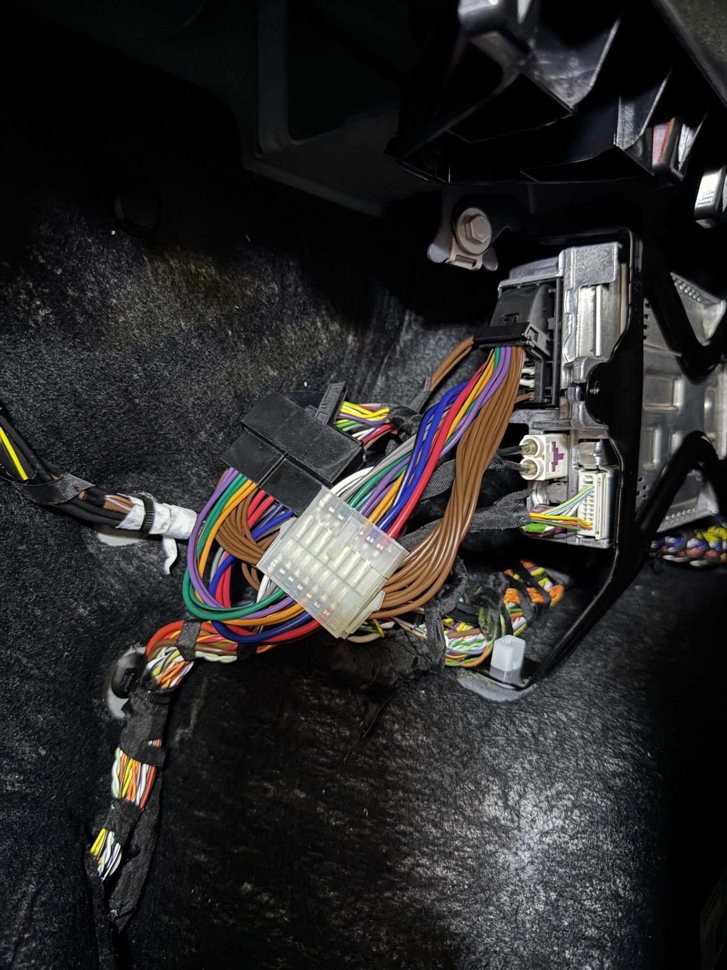

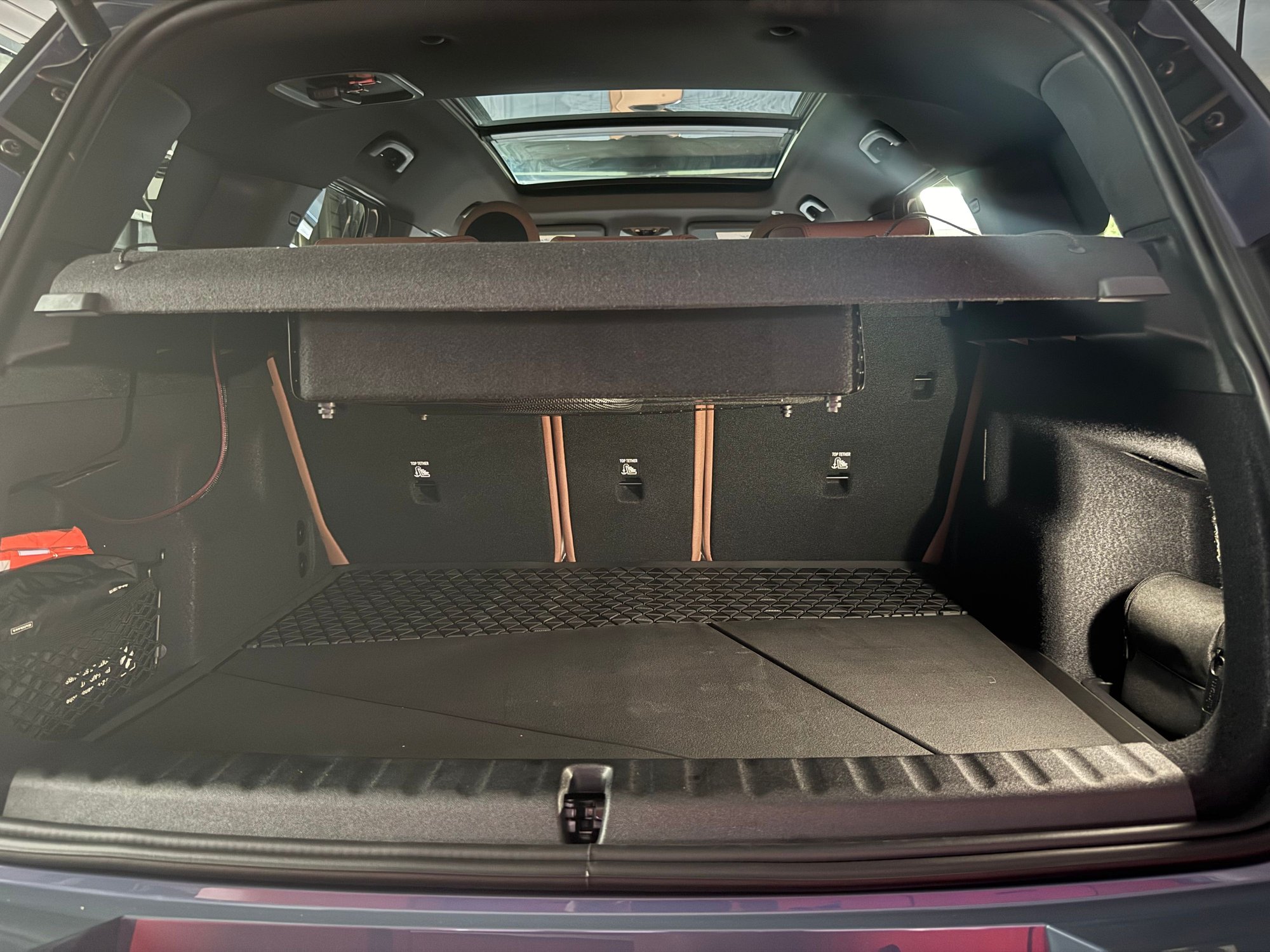

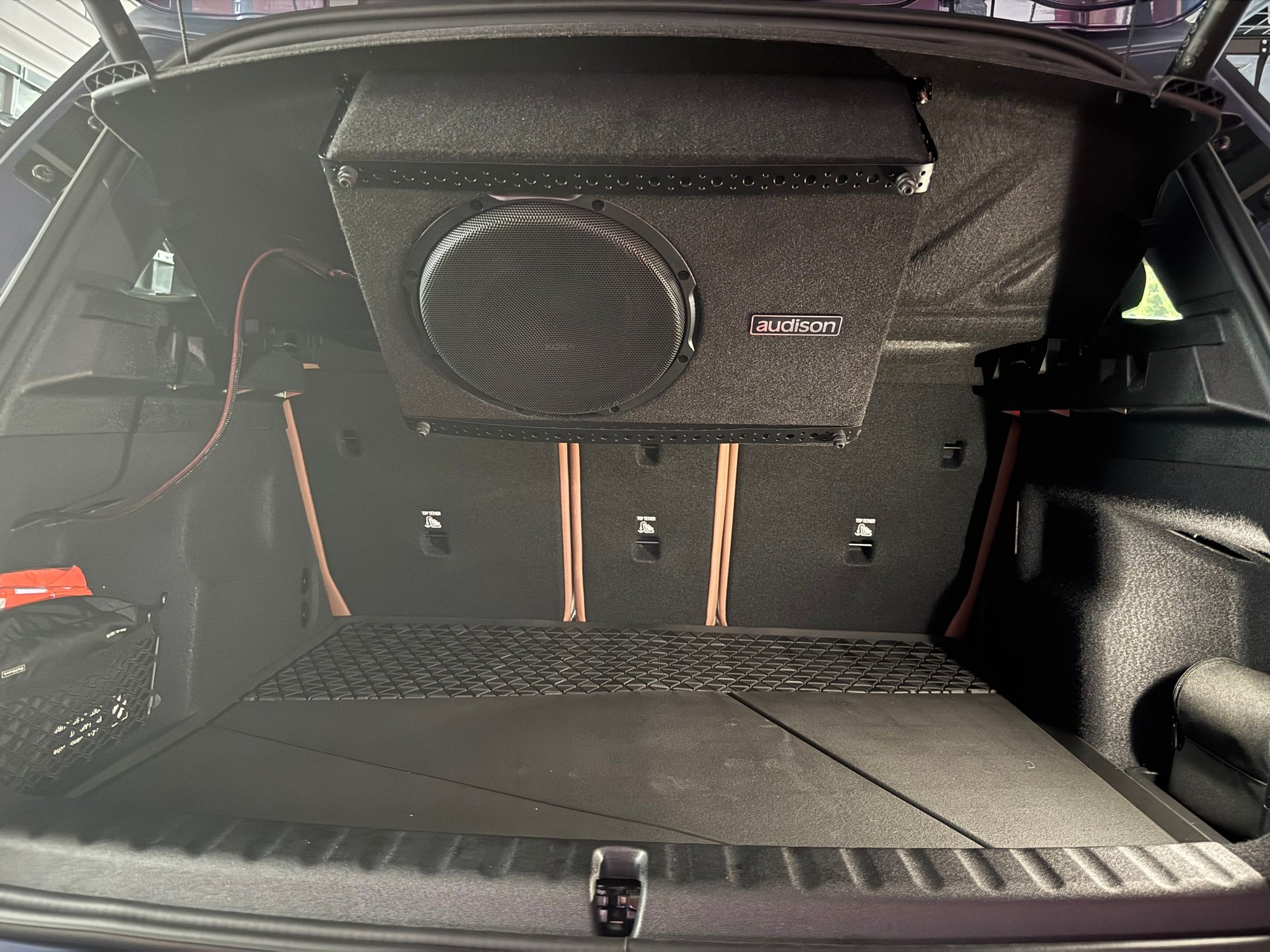

Notes on a 2025 Countryman SE with HK(688) audio system and aftermarket amp/speak
The U25 HK audio system is comprised of a RAM and a Booster modules, powering 12 speakers with a total of ~375W.
- RAM (Receiver Audio Module) powers 5 tweeters, and 5 mids. Tweeters and mids are wired in parallel, 25W per channel (5ch). OEM Mid + Tweeters are 4ohms. Tweeter have a passive high pass filter in between the mid.
- Booster module powers 2 woofers - 125W per channel (2ch). OEM woofers are 8ohms.
None of these modules can be replaced with aftermarket.
Major features of this OEM system are a 7-band equalizer, and a Surround mode.
The plan for this audio upgrade is to correct this HK system low volume clarity and bass, reduce high volume distortion, eliminate bass clipping in deep bass music, and improve all sources sound clarity at any volume, all while keeping the Surround feature and most of the OEM speakers in place.
This is the hardware installed to accomplish this plan:
- Helix V Eight DSP Mk2 - DSP and amplifier with 8ch inputs, 8ch outputs and 75W x 5ch (4ohms), 160W x 2ch (2ohms)
- Morel IP-BMWSUB82 - 8" subwoofer/midbass at 2ohms
- Audison APBX 10 DS - passive
10” sub
The only requirement of this install is to be as plug and play as possible, no OEM wires cut, spliced or tapped, and all OEM modules and OEM features not to be disturbed in any way. All 13 speakers (8ch) are powered by the V Eight.
Sound improvement at any volume, and with any type of music is just fantastic - even with most OEM speakers kept. Surround feature was kept by not performing any time alignment in the DSP.

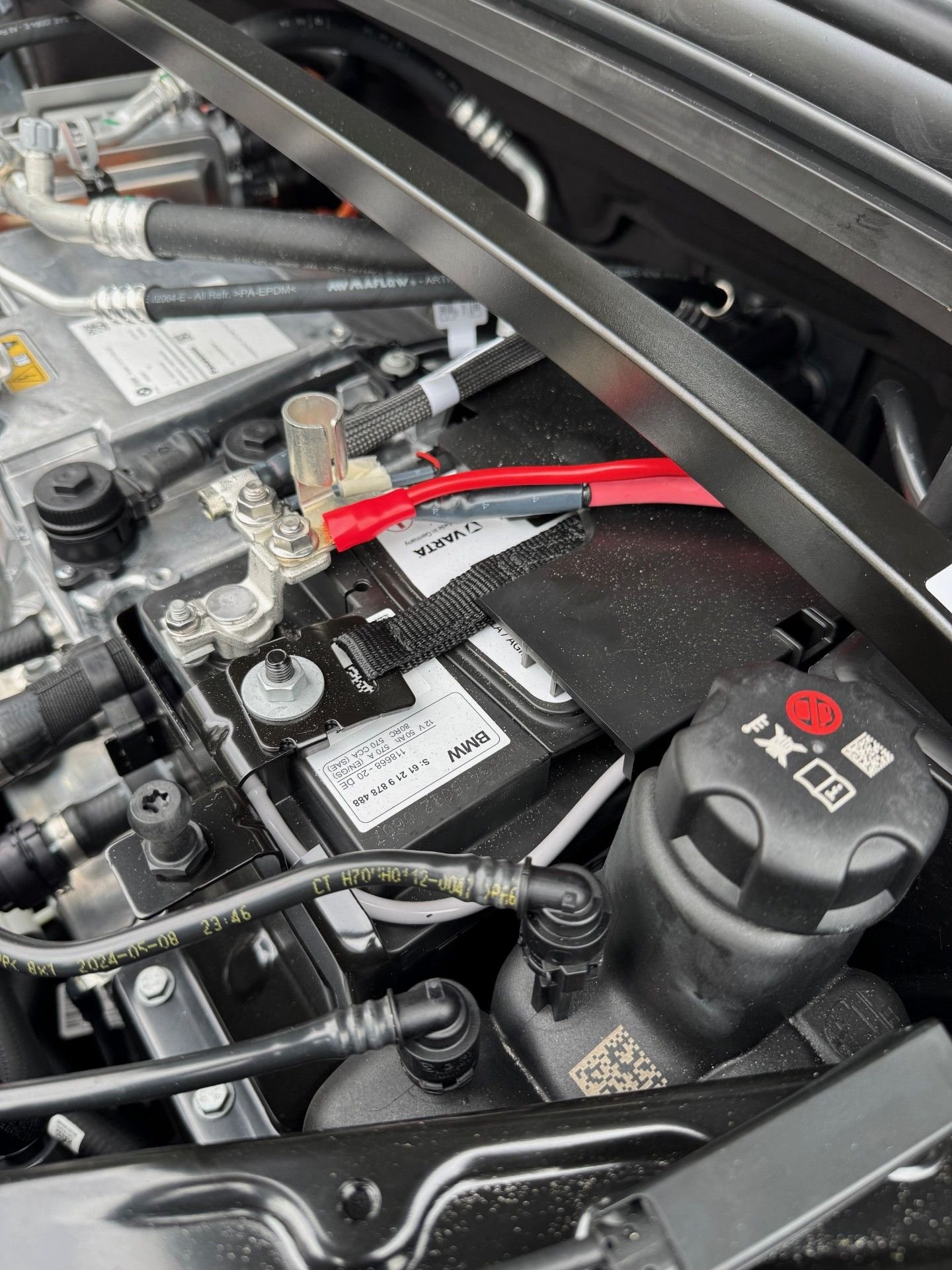

No 12V battery terminal in hatch (like in BMW), 12V cable must be connected directly to battery
50A fuse/cable run thru bulkhead grommet.
All plugged in.

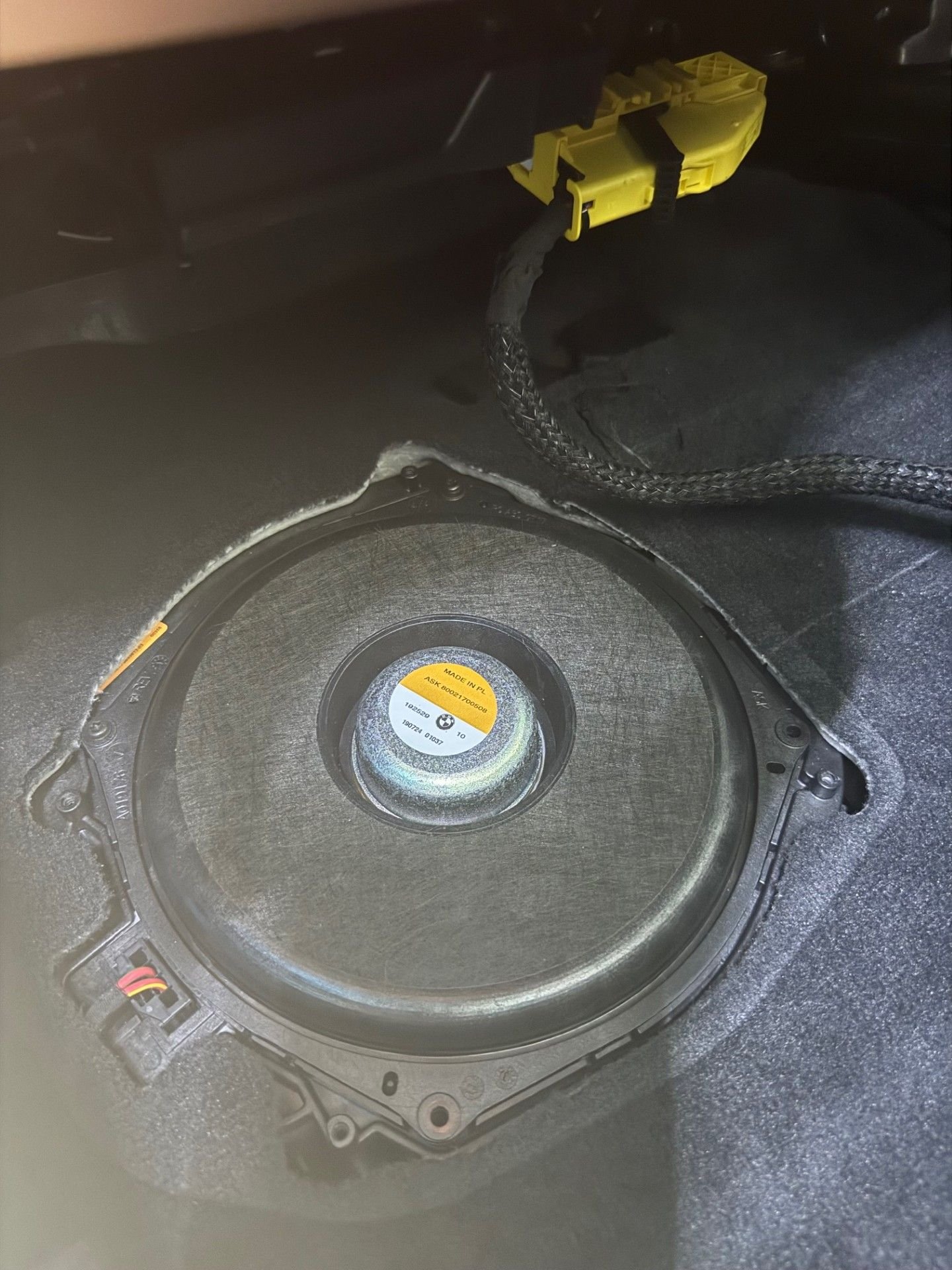

OEM woofer
Morel woofer plugged in.
Sub ‘n hatch™️

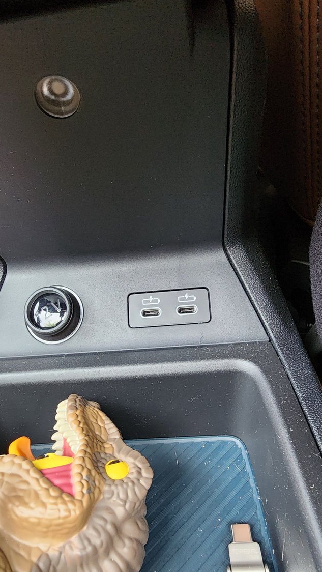

Can you see this USB logo in any of the USB ports in your U25?

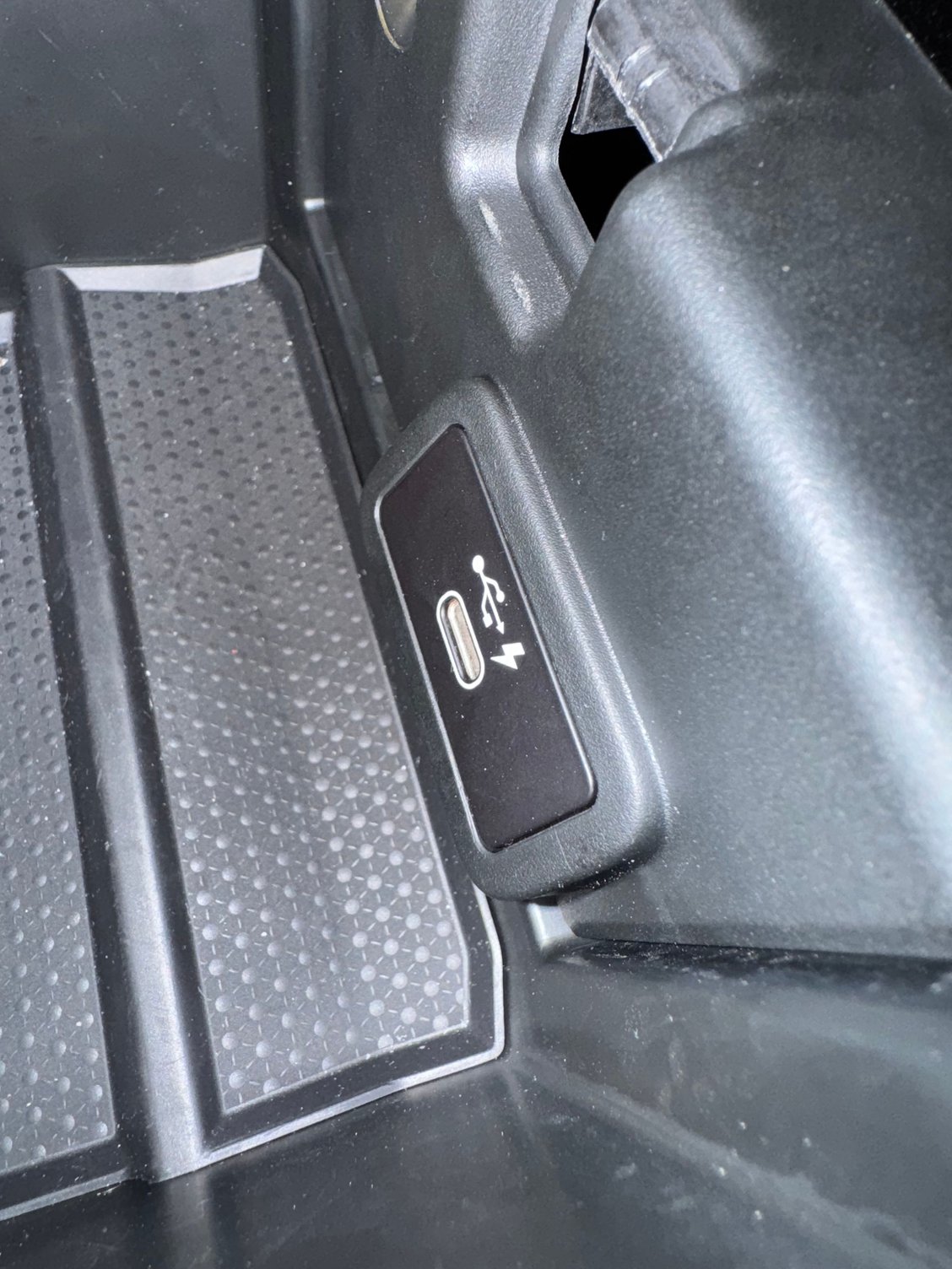

There are 4 ports. Non of them have this.. I know that the logo is for power and data. The logo only show's the power lightning flash. Now having said that, the loaner (it was a 2025 countryman) was the same and it worked perfectly.

Is this an USA U25?
Owners manual states that all USB ports are for charging, none for data. My U25 USB ports have no data capability, no data logo either. My i4 USB ports are 4 for charging, 1 for data/charging (photo).
Need to check what type of MGU (iDrive 9 OEM HU) the U25 has, as it is completely different from the i4 MGU (iDrive 8.5 OEM HU). Normally, all BMW/MINI OEM HU since 2014 have at least 1 data port among its USB ports.

Let's not add to his problem with confusing him. Both USB (front) are data on the U25. I use both for USB drives and they work fine.

That’s not what the manual of the U25 states. That’s not what my U25 USB ports do.
This is a technical problem, confusing or not.

Don't know what to tell you, my owners manual says place a USB drive in one of the USB-C ports in the center console. Mini Representatives have emailed me confirmation that both ports are active. My Center screen shows 2 USB drives and I can select from either.
This was before the OTA update and after.

7/2024.38 manual shows all USB ports are for power - no data reference. No USB port shows as audio source in the display in my U25, regardless of USB format.
7/2024.40 is being downloaded as I'm typing this.
