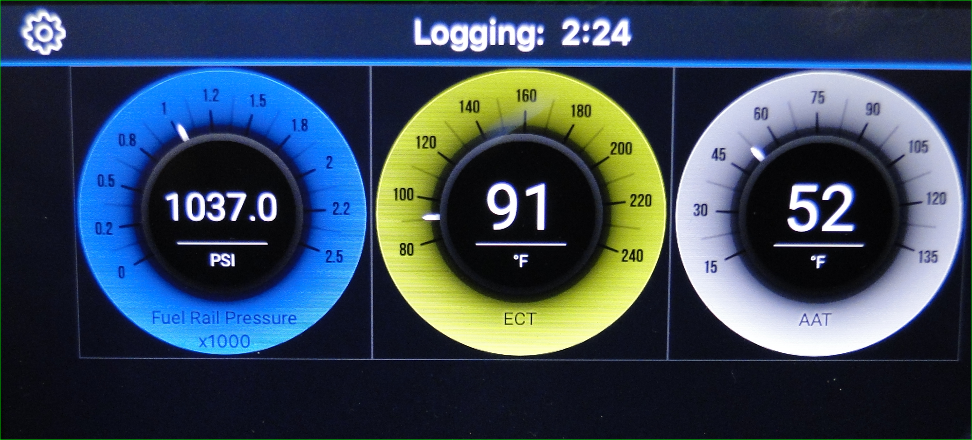

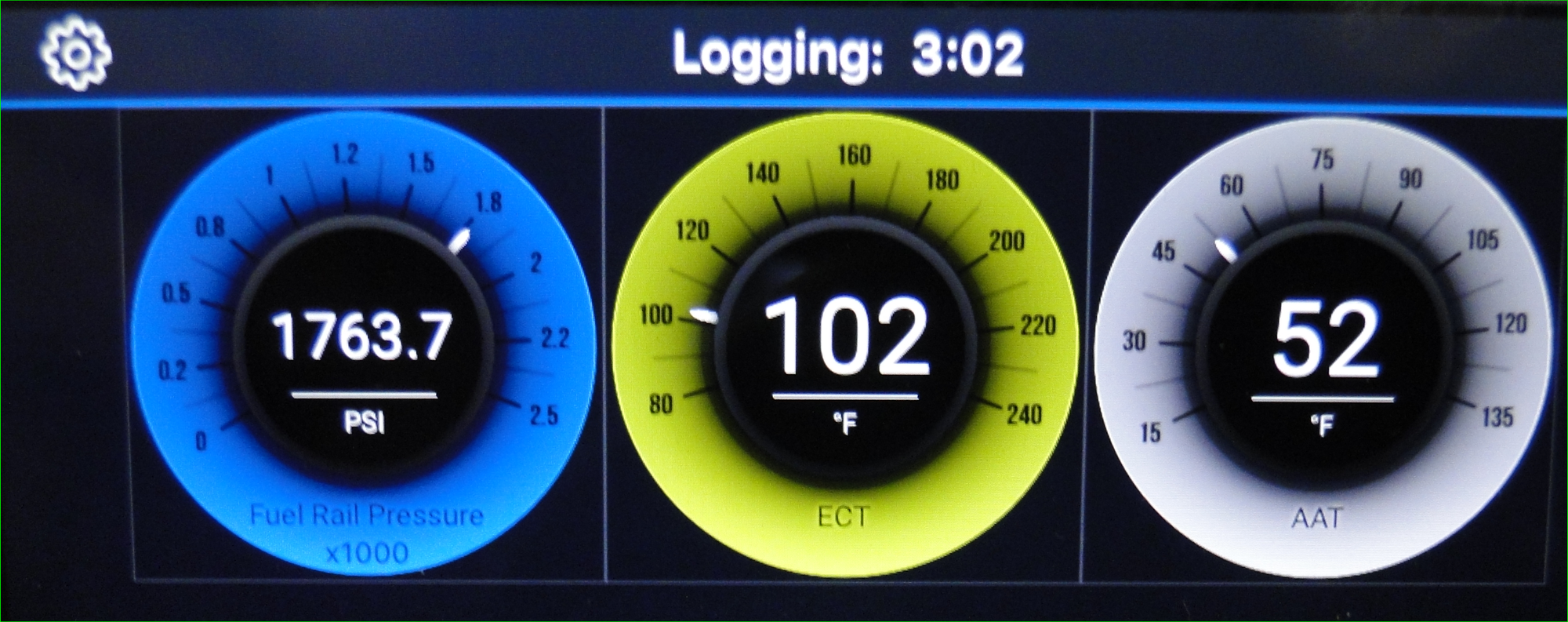

I use BlueDriver in conjunction with an old iPhone (my girlfriend's old iPhone 5, if memory serves). It's not quite as comprehensive as Android offerings, but it gives me what I need in real-time, which is ambient air temp, coolant temp and fuel rail pressure.
Just stationary today I get the below:
420kpa = 61psi (0rpm - ignition on only)
420kpa = 61psi (830rpm - engine running)
5th start - 5171kpa = 750psi (830rpm - engine running ok)
8400kpa = 1218psi (at 1700rpm)
These numbers are better, but still short the mark.
Here's my car at idle:
Fuel Rail Pressure seems to top off around 1700-1800 psi (2K-3K rpm sitting in the driveway. Actual driving pressure goes higher.).

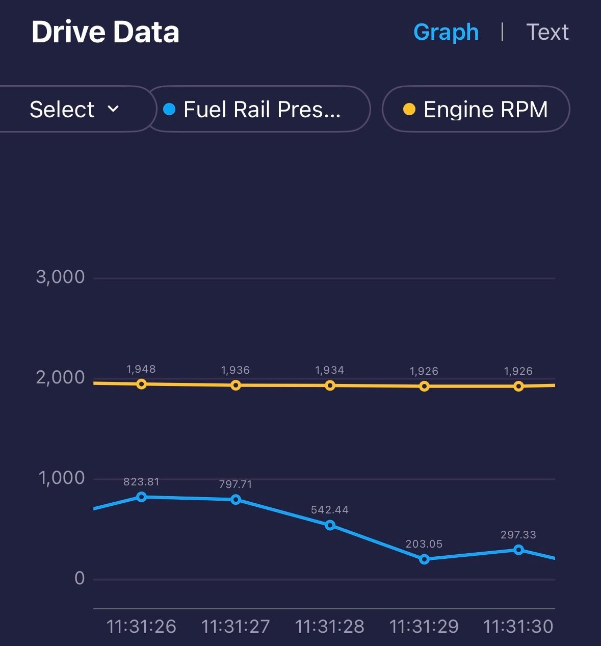

Fuel pressure in psi and RPM. First drop in pressure.
Fuel pressure in psi and RPM. Looked like pressure was about to recover then a second drop followed by limp mode (half engine light reduced power).
So for the first time it happened while I was driving along the highway. As you can see from the graphs pressure goes from the 900-1000psi (at about 2000rpm) to 73psi in just seconds followed by engine light and limp mode. After stopping the car and clearing the limp mode it drove fine but likely a sign of getting worse before complete pump failure.

Yep...looks like it's time for a new HPFP.

Thanks everyone for their help and comments. I didn’t realise how important getting that realtime data would be. Seeing it fail while driving and maintaining the LPFP psi pretty much ruled out an electrical issue, a relay issue and a low pressure pump issue.
Once again proving that Mini error codes only direct you towards a problem and you still need to do some troubleshooting.
