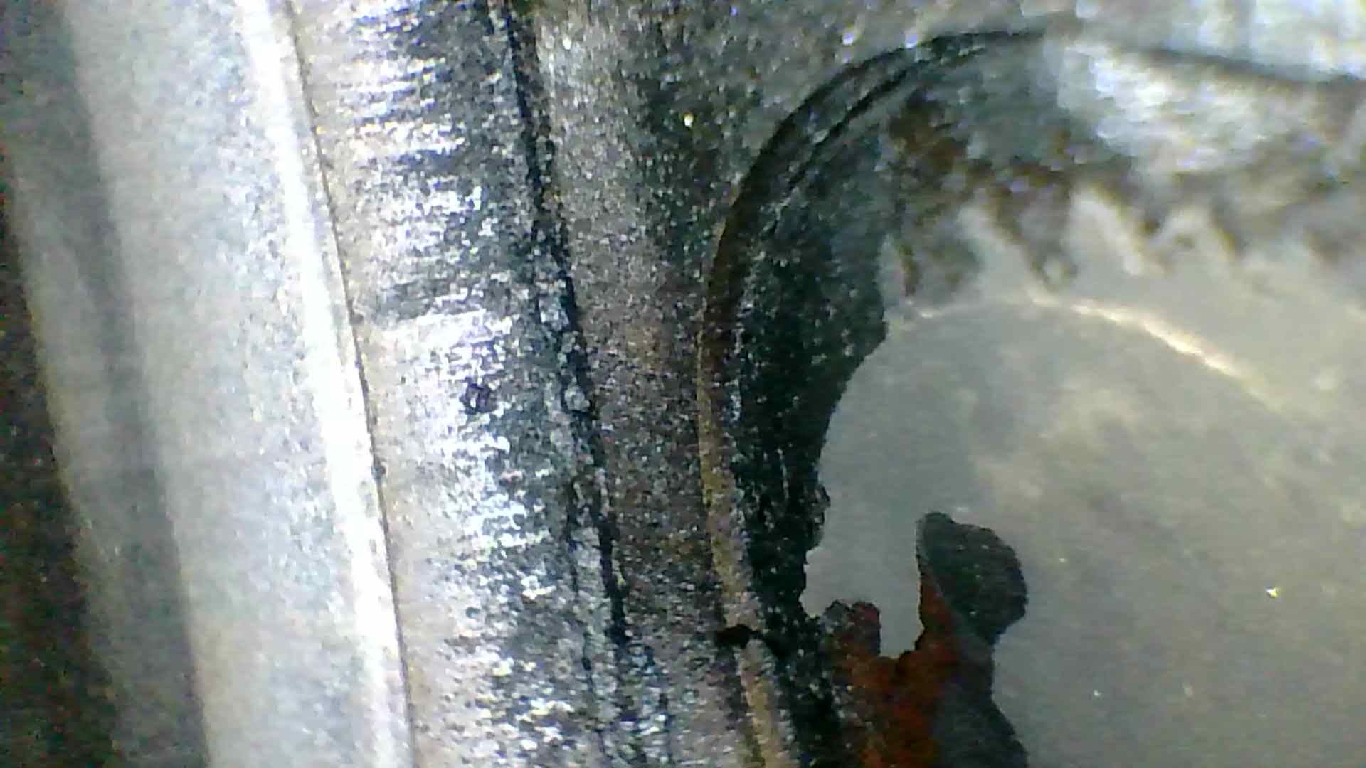

So I was able to get a borescope in the spark plug hole. It sure isn't good, but I can't tell if it is catastrophic. I need to rotate the cylinder to get the piston lower in the hole. But I don't think I'll get much better images of whatever is hanging off the valve side.
Carbon hanging off the valve? Valve Seat?
Carbon side of image is the top of the piston. Shiny is cylinder wall. Something sitting on top of the piston.
Same valve, camera rotated a bit. Looks like it is seated?
Half the picture is the fuel injector.
This is cylinder 2. Half shot of top of piston, half image of carbon on the back side of the valve and intake. Note, this is NOT the problem cylinder, yet. Valve is open, can sort of see the curve of the back of the valve.

So I guess with the above images, I know I'm at a minimum pulling the head. If nothing has crashed, maybe I can clean up/rebuild the head and be ok? If I did that, do a new timing chain while I'm there, which I don't know how to do...and haven't found a definitive thread on here to help.
Find a new head somewhere, for the price of the value of the car? Still would have to figure out timing.
If I pull the head, am I far enough into it to do a new oil pump, or does the rest of the engine need to come out for that? I don't have really good reason to think I should do piston rings...but I have had pcv issues related to pushing oil out of the front crank seal. Maybe that does indicate piston ring blow by?
Other things I'm not aware of I should do while in this situation?
