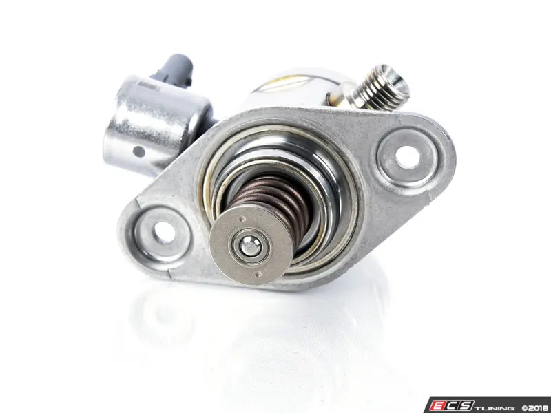

What does the VIN sticker show for build date? Early 2012 models had a flakey high pressure fuel pump....

Looks like the 3/2012+ design so you can get the bosch one if you have problems, look under the hood to the rear right on top of the engine near the thermostat housing.

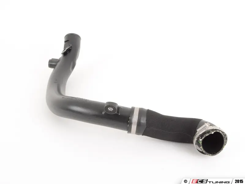

The official name for the tube is "Charge Air Line"
Item #1 here:
https://www.realoem.com/bmw/enUS/sho...diagId=13_1206
Might want to get familiar with that site. RealOEM is an excellent source for finding official part numbers. You can then take those part numbers and search the interwebs for pricing.

Use our site for pics. You can see the actual part, sometimes realoem does not show everything exact. You can see that mounted bump in the line were the screw goes.
https://www.ecstuning.com/b-genuine-...t/13719804247/

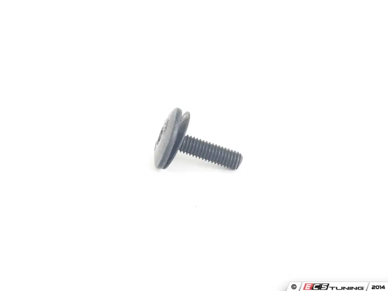

Plastic with metal nut insert. So they must have separated. That's the screw and its nota self tap or what they call a cheese head screw that goes into plastics. That tends to be a wide thread.

took a look yesterday, and the threads are completely gone on the pipe lol, the screw is fine, it was just bouncing around what was the metal threads. Is there a way for me to replace the threaded nut, or do i just need a whole new pipe?
