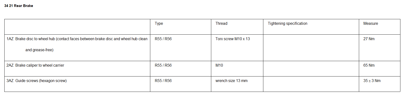

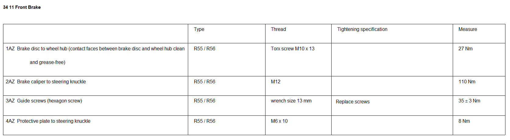

Torque specs for an R56 which should be close to what you need. Sorry everything is in Nm here a converter https://www.convertunits.com/from/N-m/to/lb-ft

torque specs from newtis
