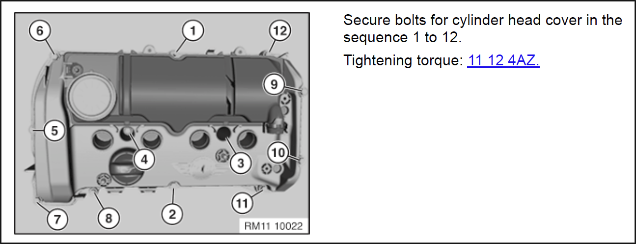

Also I noticed your tightening order was different than in the factory service manual (same: torque to 10 nm / 7.5 ft-lbs / 88.5 inch-lbs):
(yes the image below is weird, but that's what in "11 12 000 Removing and installing/sealing cylinder head cover (N18)")
edit: oh it's not weird, just missing the PCV cover...
No idea how sensitive the valve cover is to tightening order but I just thought I'd throw it out there.
