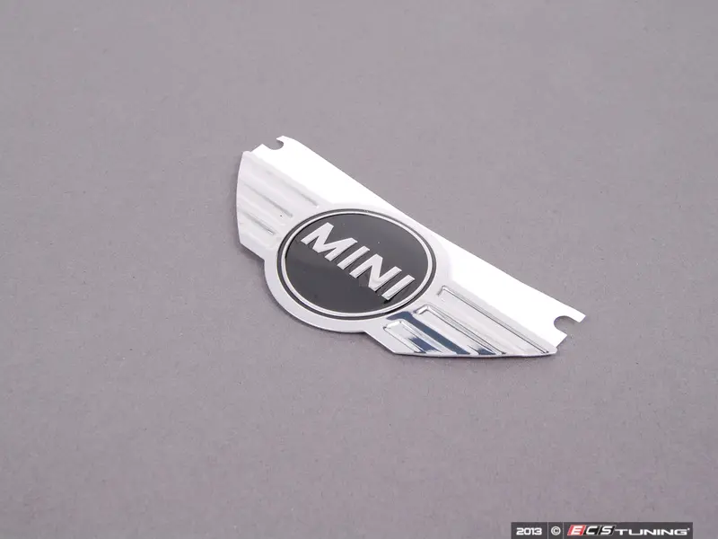

We have them here and all the sticker and emblems as the new vales covers don't include them. Unless you spilled oil there or something greasy it most lily the valve cover. 11127646555
http://www.ecstuning.com/Search/11127646555/
OEM MINI part number: 11127572851 : Click the picture below for item.
http://www.ecstuning.com/Search/11127572851/
MINI Valve cover Emblem Part # 11127594876
http://www.ecstuning.com/Search/SiteSearch/11127594876/ES514833/

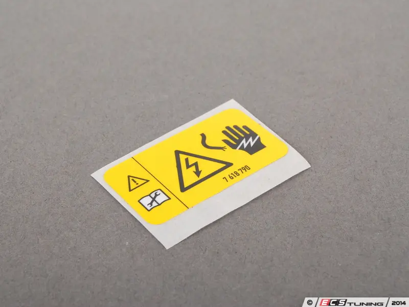

And the little yellow ignition coil sticker looks to be part #71227618790
http://www.ecstuning.com/Search/SiteSearch/71227618790/ES2674957/
And what it look like:

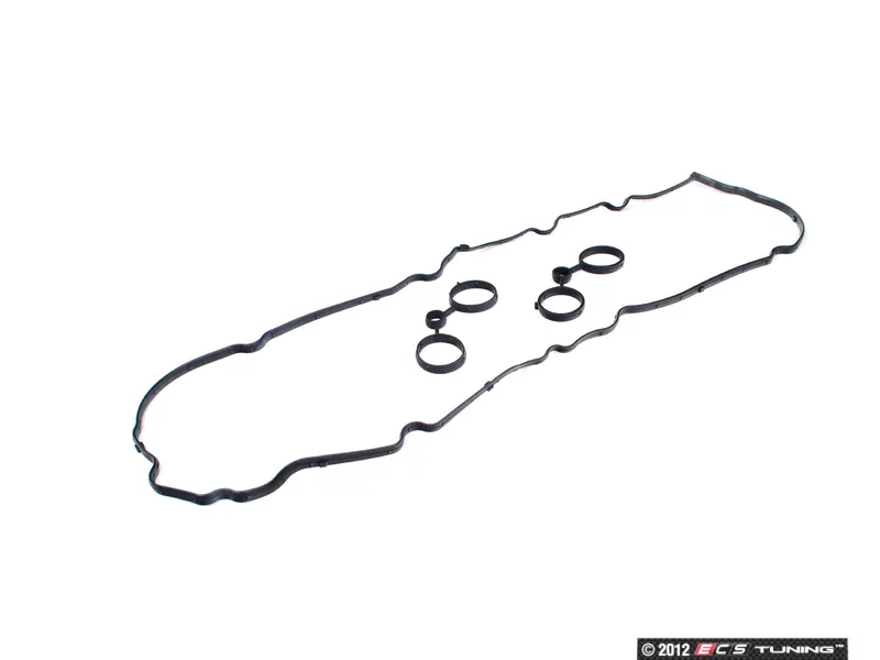

Leaks at the top of the engine are usually from the valve cover. Constructed of plastic and sealed to the cylinder head using a rubber profile gasket, the valve cover can leak a few different ways. 11-12-7-646-555-BOE is the updated cover from MINI which includes Valve Cover Gasket, Oil Filler Cap, Spark Plug Seals and Mounting Hardware. We have a DIY as well if you decide to tackle this job yourself.
