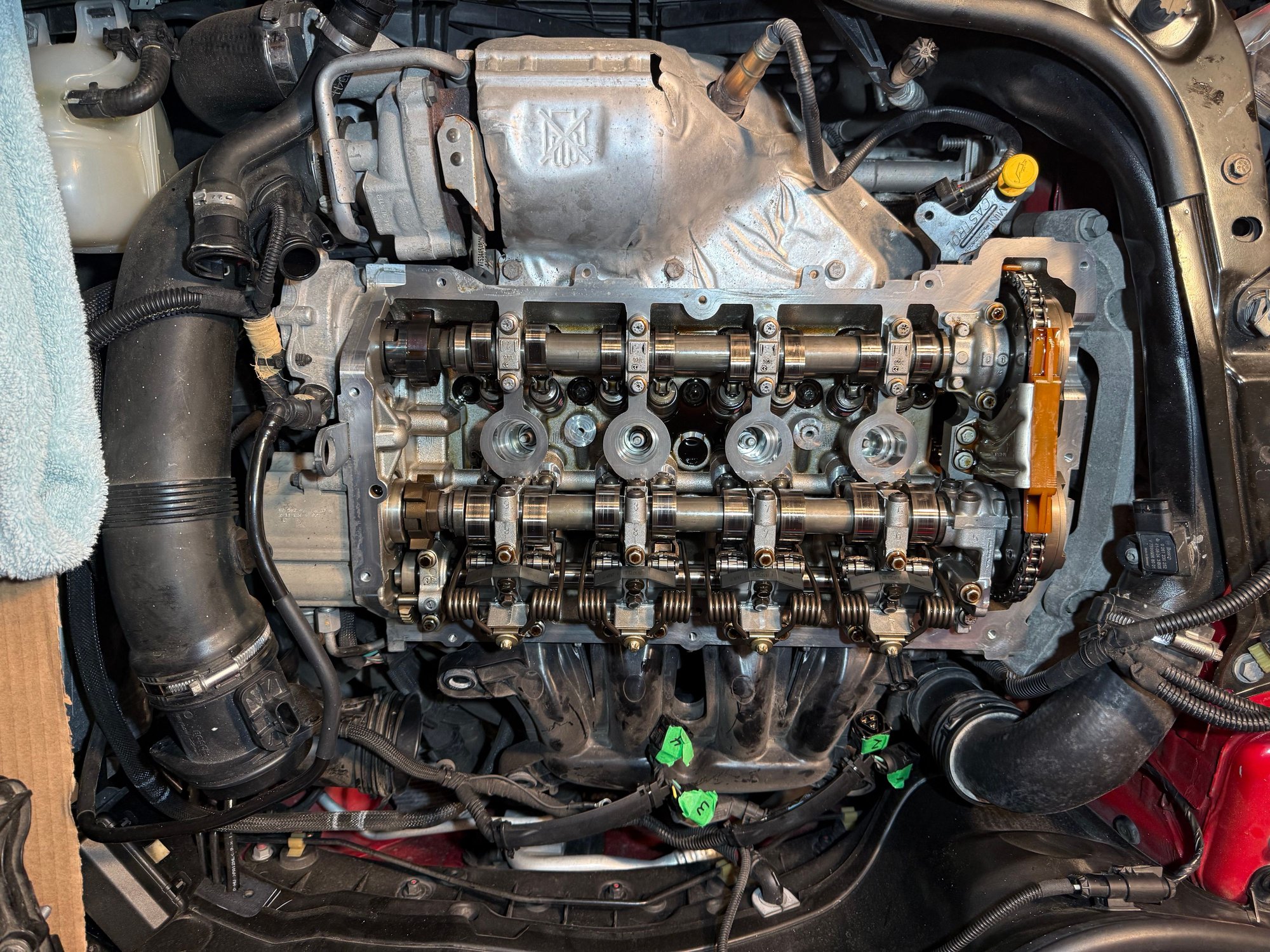

Project completed
It worked out great. Thank you for the suggestions

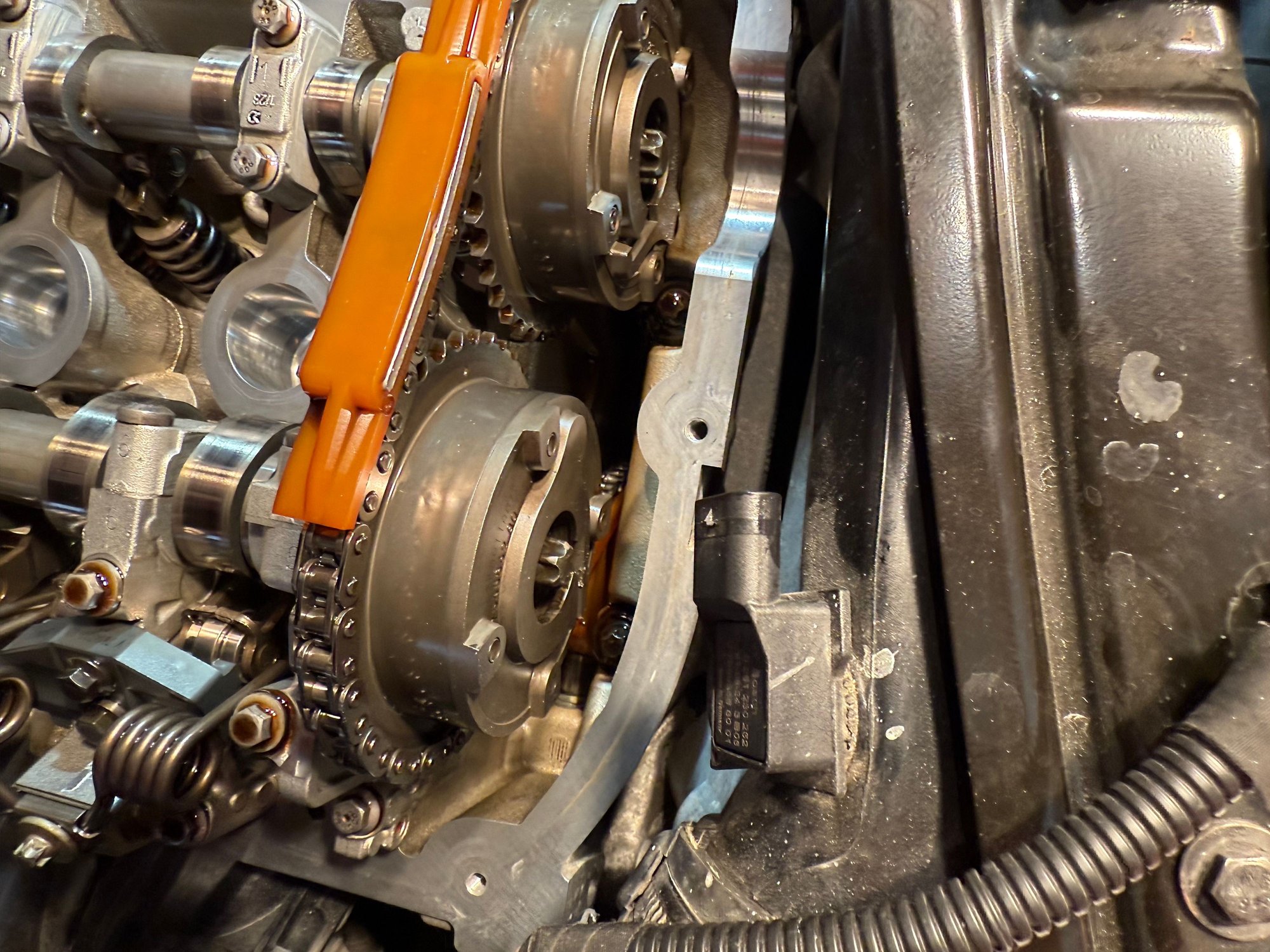

All appeared to be in tip top shape under the cover.

+1 your engine is really clean.

Perhaps the 45,000 KM (28,000 Miles) has something to do with the condition of the engine. It was running rough but that was 100% due to neglect.
When I got it in Jan (of this year) it was an extremely neglected car (My wife thought it was a turd. She has a 2018 F56, Electric Blue garage Queen with only 40,000KM so it's easy to say that when she compared them to one another). She's now changed her view and was crazy surprised by the outcome.
My other car is a Crossfire SRT-6 but this car is way more fun to drive
The paint work had a lot of really deep scratches, the bumpers were a mess and the stripes were peeling. Inside, when I peeled back the carpet install sound insulation, I discovered Interior floor was soaked in water
With the exception of oil changes, zero Maintenace/service work was done in 13 years.
The previous owner had a battery 2 sizes too small and couldn't work out why it was a poor starter. This was the last week/(end) for service and appearance. The clean-up and service took me 6 months, it's now in 100% condition for a Road trip to the west coast
