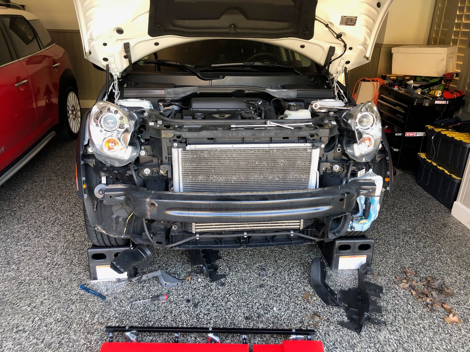

But now, after seeing an upgraded intercooler installed, I have some concerns. Mainly, isn't most of the additional cooling area provided by the upgrade is being blocked by the crash bumper. And with the new intercooler being squeezed against the crash bumper, the only part that receives direct airflow is the same size as the OEM intercooler. I'm I missing something?

Great question, the photo I posted was before the old intercooler was removed and new one installed. The new IC has plenty of room to receive airflow around the crash bar just as the radiator and AC condenser. The upper section extends above the crash bar.
I was hesitant until reading others post, including independent Mini shops, recommending IC upgrades as part of a larger plan to enhance performance.
