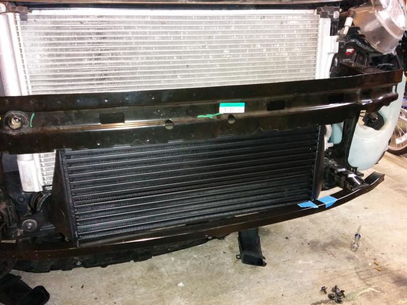

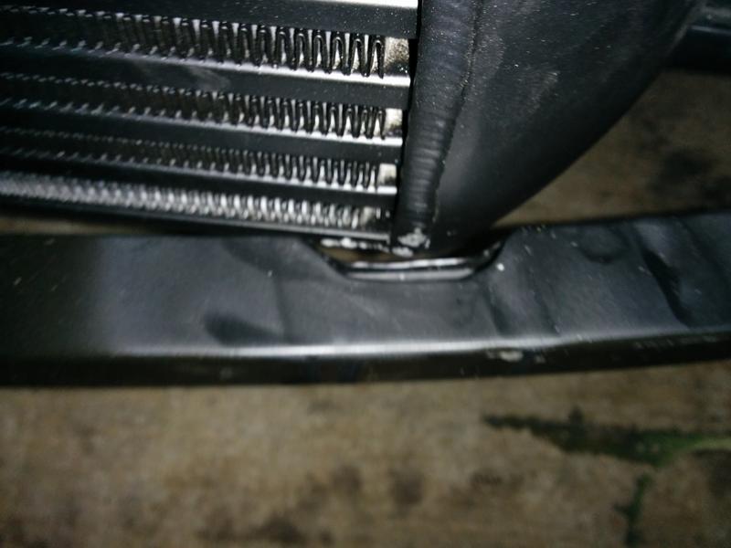

Finally got the installation complete.
The Wagner intercooler is beautifully crafted and finished, truly a quality piece. No complaints there. Unfortunately the installation was not straightforward, it does not directly fit a 2012 MCS. The front crashbar has a lower bar that fits inside the bottom of the bumper cover, I had to remove the crashbar to fit the intercooler. OK, no big deal, take out a few nuts and bolts. Hook up the hoses and tighten the clamps. To get the crashbar back on, I had to cut off the top tab as it is under the top bar and sticks up to high. OK, put the cutoff wheel in the Dremel and take care of that. Then there is an interference between the intercooler and the lower bar at the bottom corner on the driver's side. (See pic, the blue tape on the lower bar shows where the interference is.) If you replace the crashbar and tighten everything down, it pushes the intercooler, radiator, and all the bumper cover mounting points back making it impossible to get the bumper cover lined up properly. After 4 hours of struggling with it I took pictures and contacted Wagner, their response was that the lower bar is only present on US vehicles for the later years, and the bar has to be modified to get it to fit. Oh well, so much for compatibility with the R56 "facelift" version. I have a dim memory of reading about this same issue in another post somewhere.
So I got out the angle grinder and ground a notch out of the back of the bar to clear the corner of the intercooler, sprayed it with some black enamel I had in the garage, and got it all put back together. Even with the crashbar no longer pushing on the intercooler and deforming things, it was still a ***** to get the bumper cover properly aligned on both sides. I had to trim a couple of tabs on the backside of the bumper cover, but not much. I'm no stranger to taking cars apart, I have had the front bumper cover off of my other cars to replace headlights, and none were as tough as this one. Finally got it back together, put the wheels back on, and went for a test drive.

No regrets on the Wagner. While the install was not direct plug and play, I'd still make the same choice.
My decision process: I wanted an intercooler that used the front mounting points and didn't just hang from the hoses. That disqualified Alta and Helix, even though those both appear to be excellent build quality. That left Forge and Wagner as the options. I chose Wagner over Forge based on the cast end tanks and the fact that they publish their flow data.
As a practical matter, with that lower front crash bar, I don't know if any of the available aftermarket intercooler options would fit without modifications. Maybe the Forge would, it depends on the shape and dimensions of the lower corner of the end tank.
