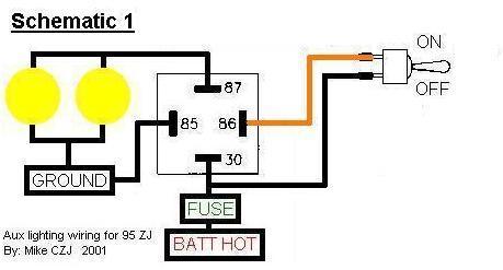

Two concerns:
This works fine for simple DL installs. The factory kit is NOT a simple install ... it is more complicated with the auto reset functions etc {and why the kit is $$ and install $$}
(a simple install would be to just wire and on/off switch with one relay. diagram for comparison:
A legal install moves the wire from the battery to the switch to be bright on to switch ... so the switch is only hot when brights are on.)
