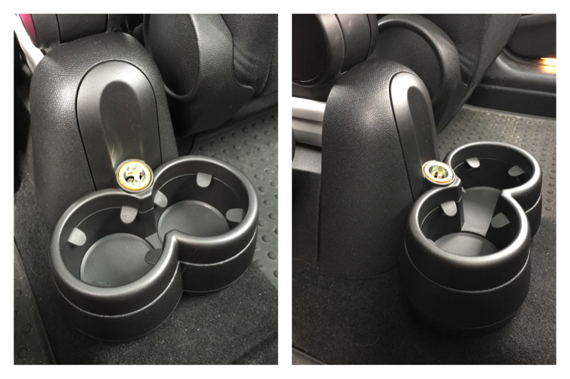

Doesn't look like it was ever any different now.
Looks very nice. thank you. I can see that I will need to get the different end cap for my rail, and probably want to add the power socket as well[ ours lives at the far end of the rear rail on our Countryman]
