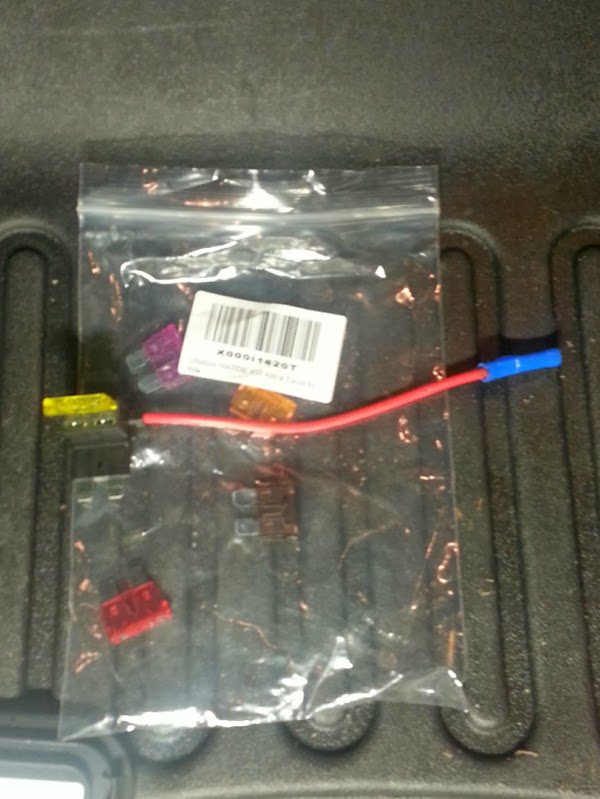

Basically I used this add a circuit device
and ran the Direct-wire Power cord up the pillar and tucked the wire in under the rubber seals.

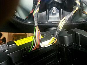

Also here is a picture of the wires in my car above the Rear view mirror as directed in the post above.

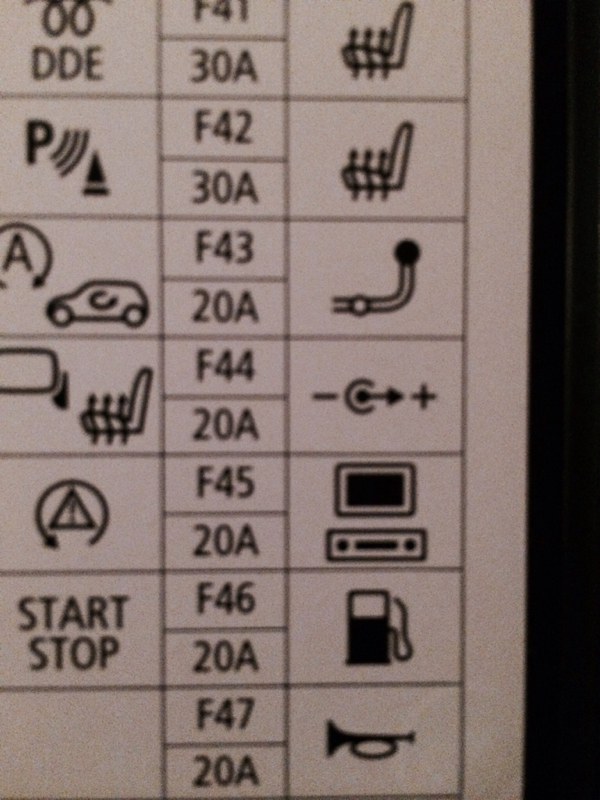

I am using F44. It turns off when the car shuts off. However I am not sure what that symbol represents... But it works!
Attachment 86372
I believe that is the cigarette lighter/power plug in front of the cup holders.

I will try slot 44 and see what happens. This would be better than splicing into any new wires. Anyone else who is doing this how are you grounding your connection?

Fuse slot 44 was the key. which I believe is the cigarette lighter fuse.. Everything is off and all is well
Glad it worked! Where did you ground it? I had a horrible time finding a ground screw, so I connected it to the screw that holds the cupholder in place. Horrible solution but it worked, so I went with it.
