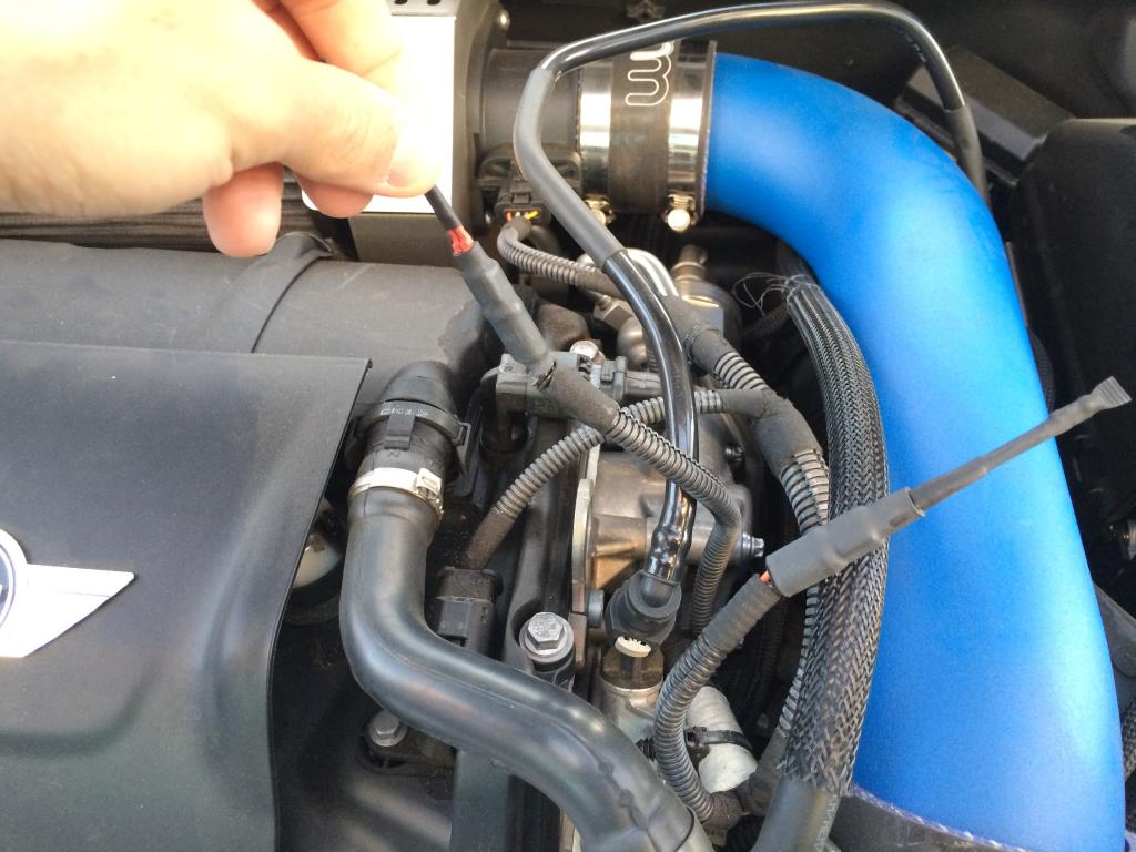

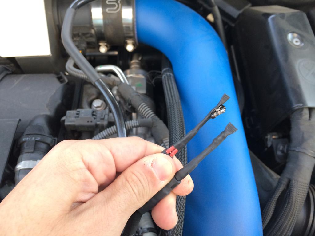

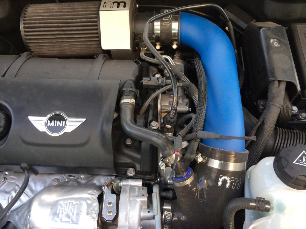

Ok... I have an update on this situation.
I gave up and just took the car to the dealership, even though it's a lease and I've modified it.
I got lucky and got a great service advisor who took the car in and called me and said that the 37DE permanent heating and ventilation fault I'm getting is definitely related to the install of the intake.
However, the issue he told me that is happening is that 1 these 2 mysterious cables that are capped off and go to nothing, rubbed against something hot in the engine and shorted out.
He didn't tell me what these cables are for, or where they went to on the stock intake, or if they even went to anything but from looking at it, they are BOTH on the same loom as the MAF and CAM Position sensors.
CAN ANYONE PLEASE TELL ME WHAT THE HELL THESE ARE, WHY THEY ARE CAPPED OFF, WHAT THEY WENT TO BEFORE, AND HOW IN THE HELL I CAN REPLACE THE BURNT ONE???
Old Dec 30, 2013 | 10:44 AM
52804x4's Avatar
52804x4
Joined: Jan 2012
Posts: 668
From: Lone Tree, CO.
Not sure what exactly they are plugged into...looks like sensors of some type...
:EDIT: Looks like I got one of those (upper one) wrong...
