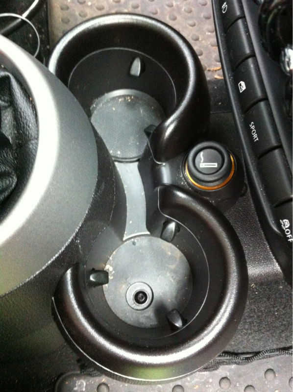

Step 2: Remove the following rubber inserts: 2 cup holders and center rail. For cup holders, start at middle between both and rub your finger towards desired cup holder until a little bit lifts and then grab and pull out. For center rail, start from the rear.

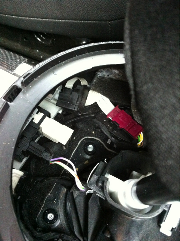

Step 4: Lift center trim panel lightly, disconnect USB/aux ports. Squeeze connectors.

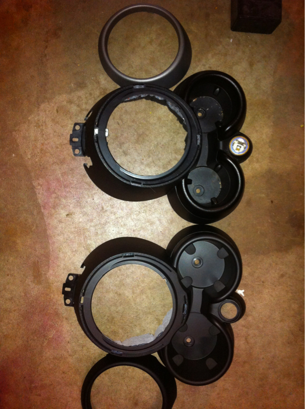

**********************************Update 5/26/2013**********************************
Pictures posted!
******Thank you kerrys914 for the photos!******

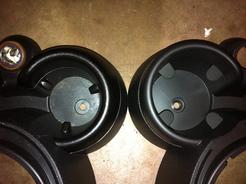

Here you can see the size difference in the rubber pads ('12 and '13). The larger is 2013+
Attached Thumbnails Bigger cup holders for 2011-2012 owners-img_0451.jpg   Bigger cup holders for 2011-2012 owners-img_0453.jpg

FYI, this mod cost me less then $60 and took 2 weeks to get the parts from Mini. Well worth the $60 and wait.
Best of luck
