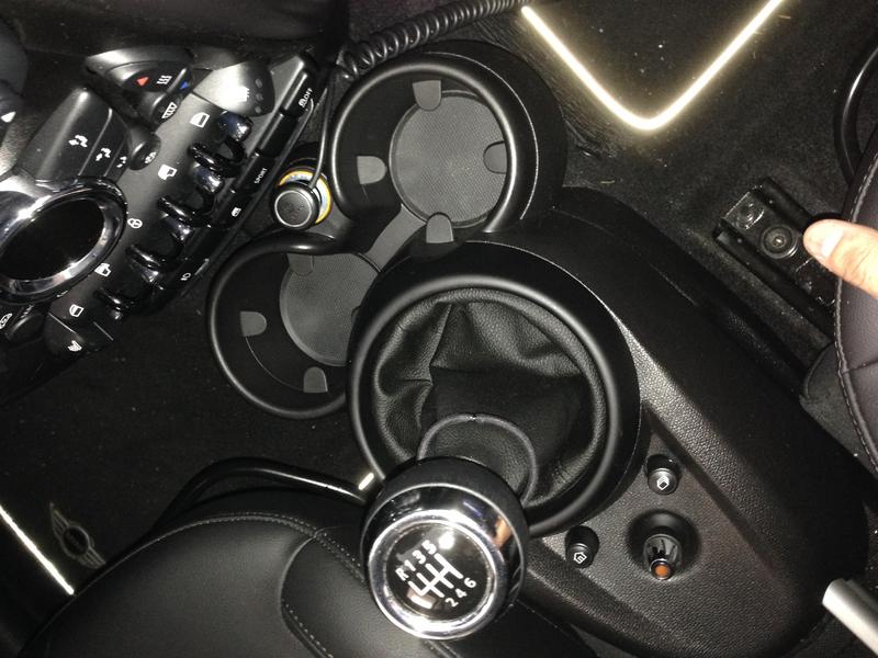

BAM.. with the NAV
so yea the ring is different, make sure you choose the COLOR you want.. they have the black, grey with the chrome, grey, and thats it. Theres a SLIGHT different between the rings... the 2013 rings have a dip in it where bigger cups go. I dont see it being an issue if it had the order rings it in.'
EASY swap out.
Oh and i have an extra 2013 WITHOUT the nag cup holder if you want it for $20 plus $10 for shipping. or if you're in Massachusetts u can pick it up.
